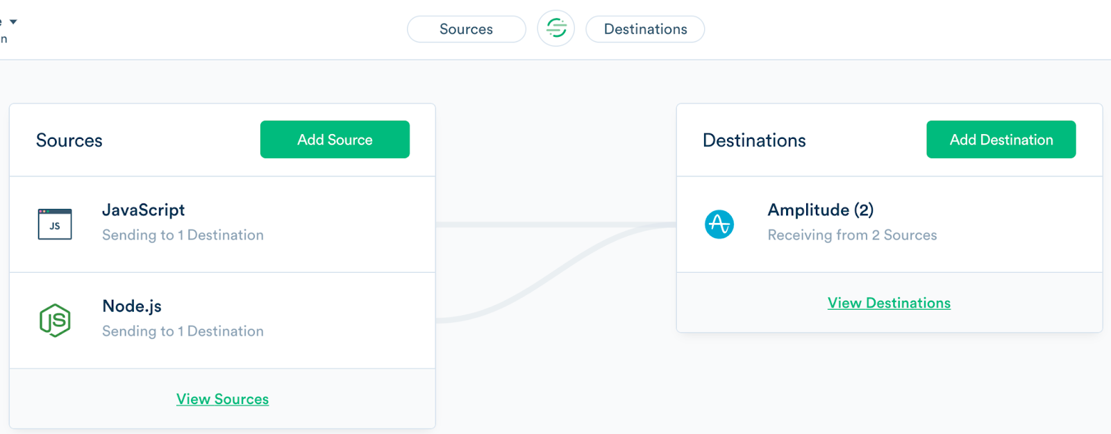

  1. Has Amplitude been enabled as a destination?
    Amplitude must be explicitly added as an integration for each source in your Segment instance:

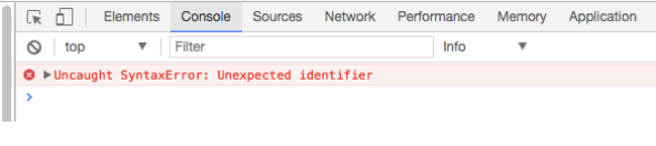

  3. Is the syntax correct?
    Sometimes it is not obvious that there are instrumentation errors, so always double-check the code for syntax errors (Browser’s ‘Console’ tab can be helpful):

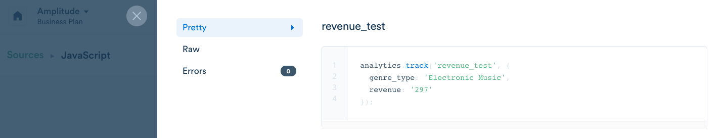

    After going through the above steps and confirming those requirements are correct, send data to Amplitude by calling track. Data will be visible after you track your first event.

Check your Debugger tab to see if there are any errors. If there are no instances of the missing event in the Debugger, try to send a test event of that event type. If the event never comes through to Segment in the first place, then it won't show up in Amplitude.

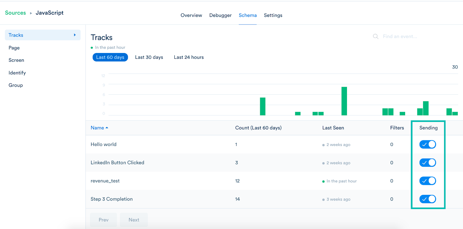

Does the event exist in Segment?
For track calls, you can choose to only send certain events to certain integrations. So double-check if the event is sending and that Amplitude is enabled.
You can also enable/disable specific integrations directly in the instrumentation code, so check that Amplitude isn't disabled in the actual code.

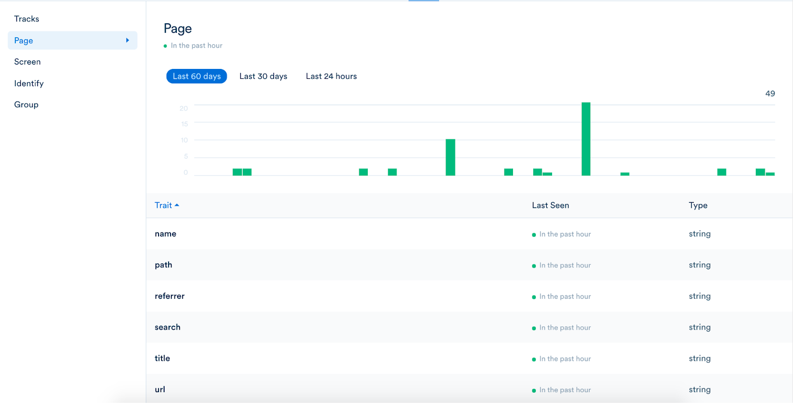

For page/screen calls, there's no way to see all the individual names of the pages but you can see from the activity if page calls are being received by Segment.

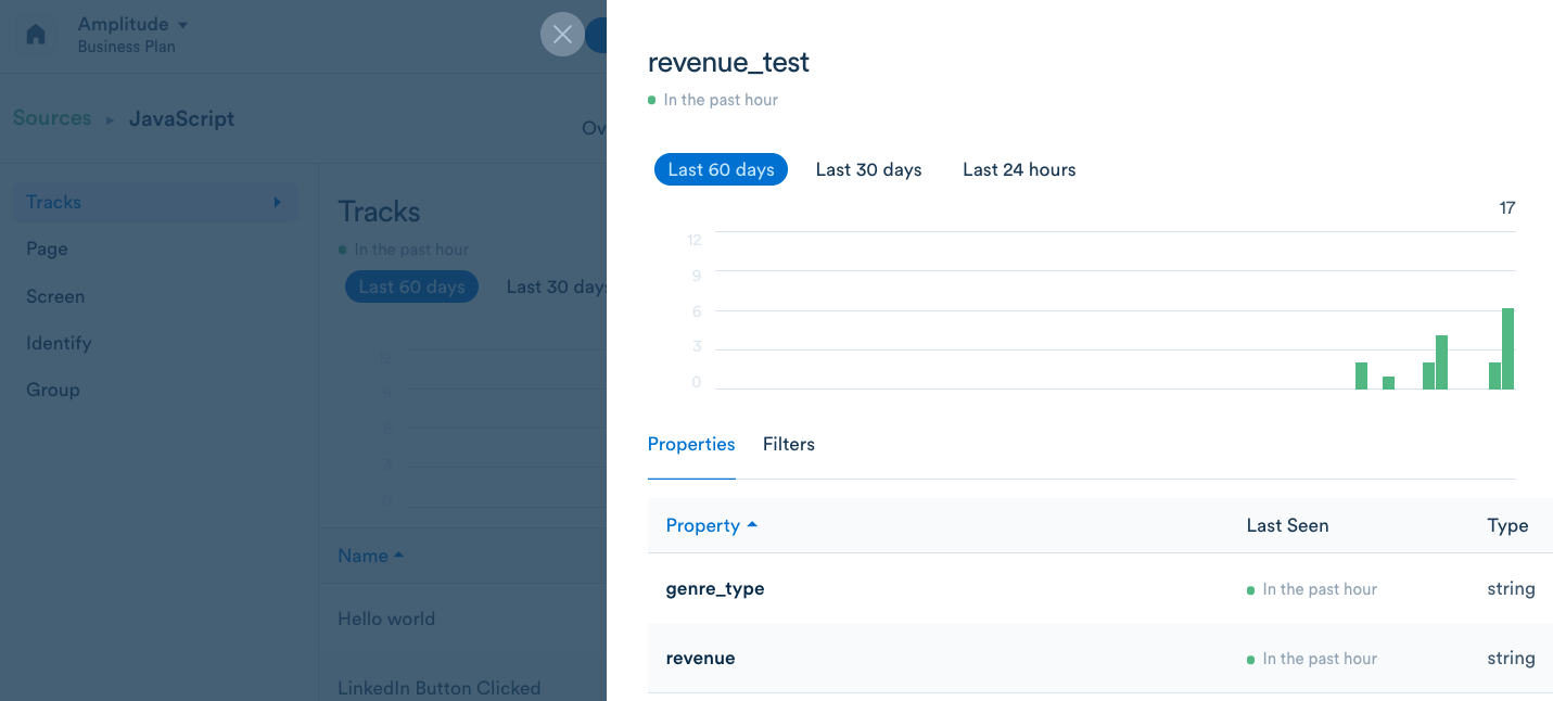

Did the property come through in the raw payload to Segment?
If you don't see it in Segment, you won't see it in Amplitude. Check your Segment's debugger to make sure that the property appeared in Segment first.
Does the property exist in Segment's schema?
Check your tracked properties and make sure they exist in Segment.
Spot any syntax code errors/other instrumentation errors?
