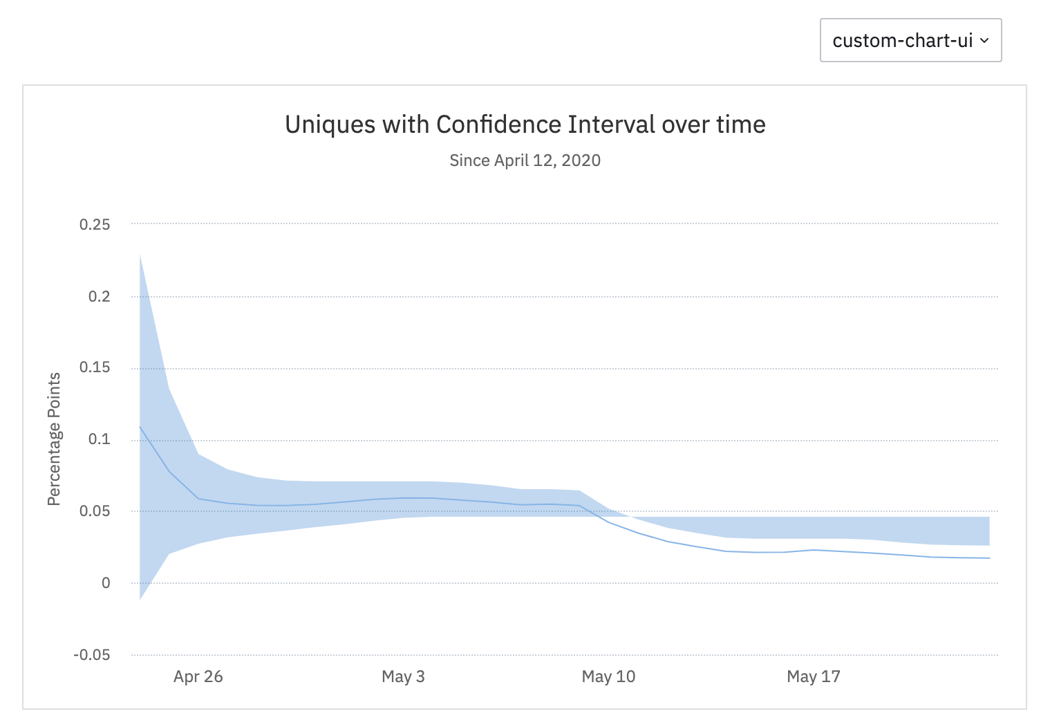

Why does absolute lift exit the confidence interval?
Occasionally you may see the absolute lift exit the confidence interval, which can cause confidence bounds to flip. This happens when the parameter you’re estimating (i.e. absolute lift) changes over time and the allocation for your treatment and control has changed. The underlying assumption in the statistical model Experiment uses is that the absolute lift and variant allocation do not change over time.
The good thing about Experiment’s approach is that it’s robust to handle symmetric time variation, which occurs when both the treatment and control maintain their absolute difference over time, and their means vary in sync.
One option is to choose a different starting date (or date range) where the absolute lift is more stable and the allocation is static.

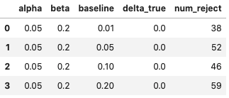

Below is a visualization of p-values over time in a simulation we ran of 100 A/A tests for a particular configuration (alpha=0.05, beta=0.2). As we ran a T-test on data coming in, we peeked at our results at regular intervals. Whenever we see the p-value fall below alpha, we stop the test and conclude that it has reached statistical significance.
You can see the p-values fluctuate quite a bit, even before the end of our test when we’ve reached 10,000 visitors. By peeking, we are inflating the number of false positives. The table below summarizes the number of rejections we have for different configurations of our experiment when we run a T-test.
Here, baseline is the conversion rate of our control variant, and delta_true is the absolute difference between our treatment and the control. Since this is an A/A test, there is no difference. With alpha set to 0.05, we can see that the number of rejections far exceeds that of our threshold that we set for our Type 1 error if we peek at our results—num_reject should never be higher than 5 in this example.

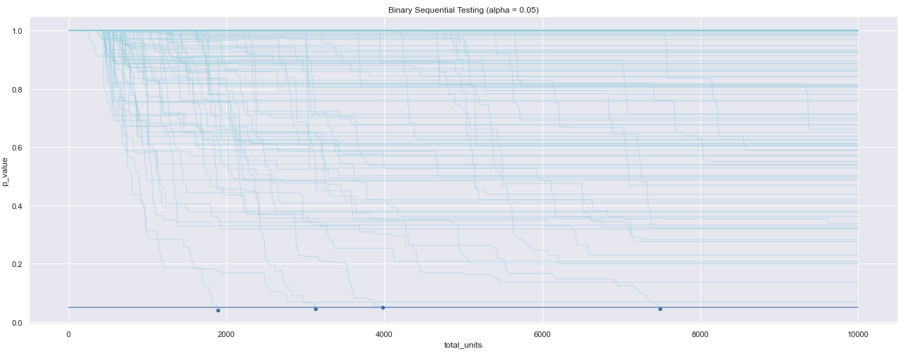

Now compare that to a sequential testing approach. Again, we have 100 A/A tests, and alpha is set to 0.05. We peek at our results on a regular interval and if we see the p-value go below alpha, we conclude that the test has reached statistical significance. As a result of using this statistical method, the number of false positives stays below this threshold:
With always-valid results, we can end our test any time the p-value goes below the threshold. From 100 trials where alpha = 0.05, the number of those that fall below that is four, so Type 1 errors are still controlled.

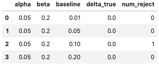

The table below summarizes the number of rejections we have for different configurations of our experiment when we run a sequential test with mSPRT:
Using the same basic configurations as before, we see that the number of rejections (out of 100 trials) is within our predetermined threshold of alpha = 0.05. With alpha set to 0.05, we know that only 5% of our experiments will yield false positives, as opposed to 30-50% when using a T-test. With sequential testing, we can confidently look at our results and conclude experiments at any time, without worrying about inflating false positives.
