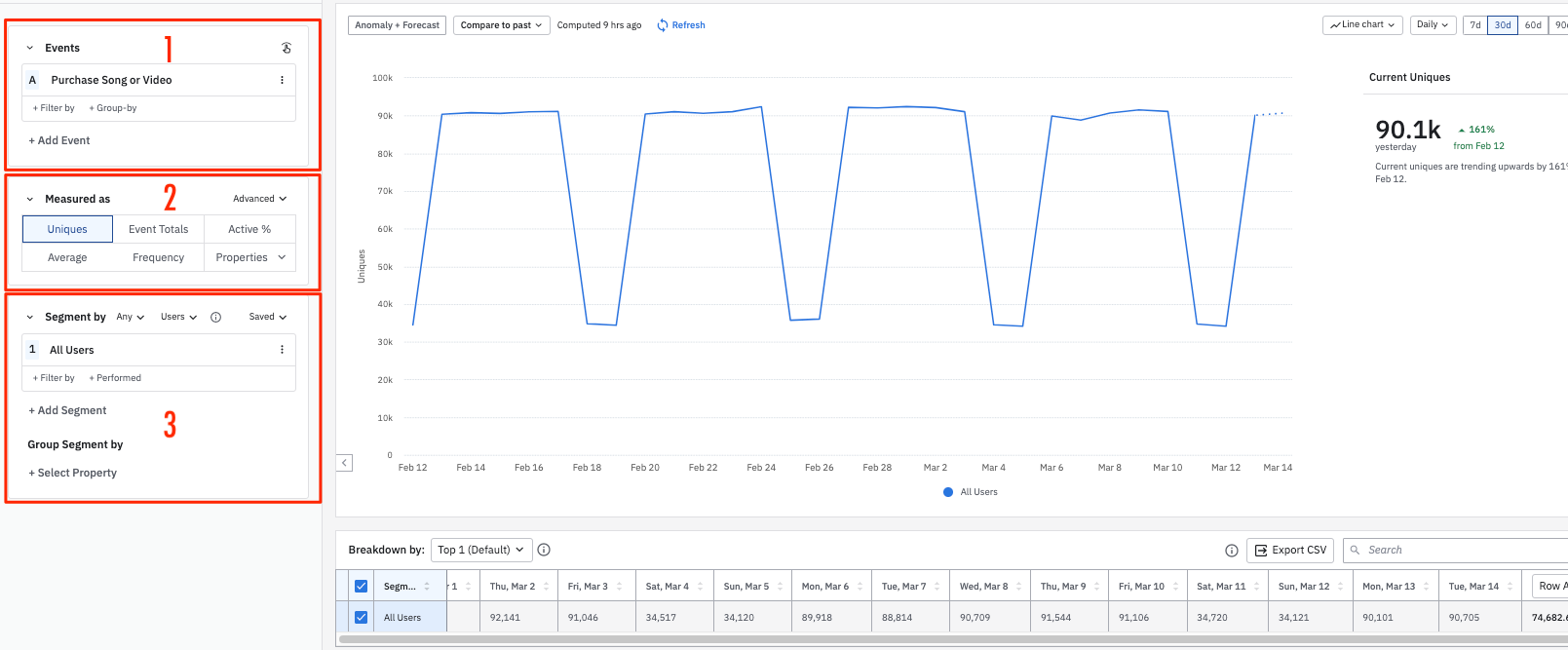

Amplitude builds charts using three modules located along the left side of your chart. Their specific function can change from chart to chart, they follow some general guidelines:
This article explains how to use the Events module. Once you're done here, check out our article on adding user segments to your Amplitude charts.

To add an event to an analysis, navigate to the Events module and click Add Event or Metric. This brings up a list of all available events. You can add up to 10 events to an analysis. An event must first be instrumented before it appears in this list.
