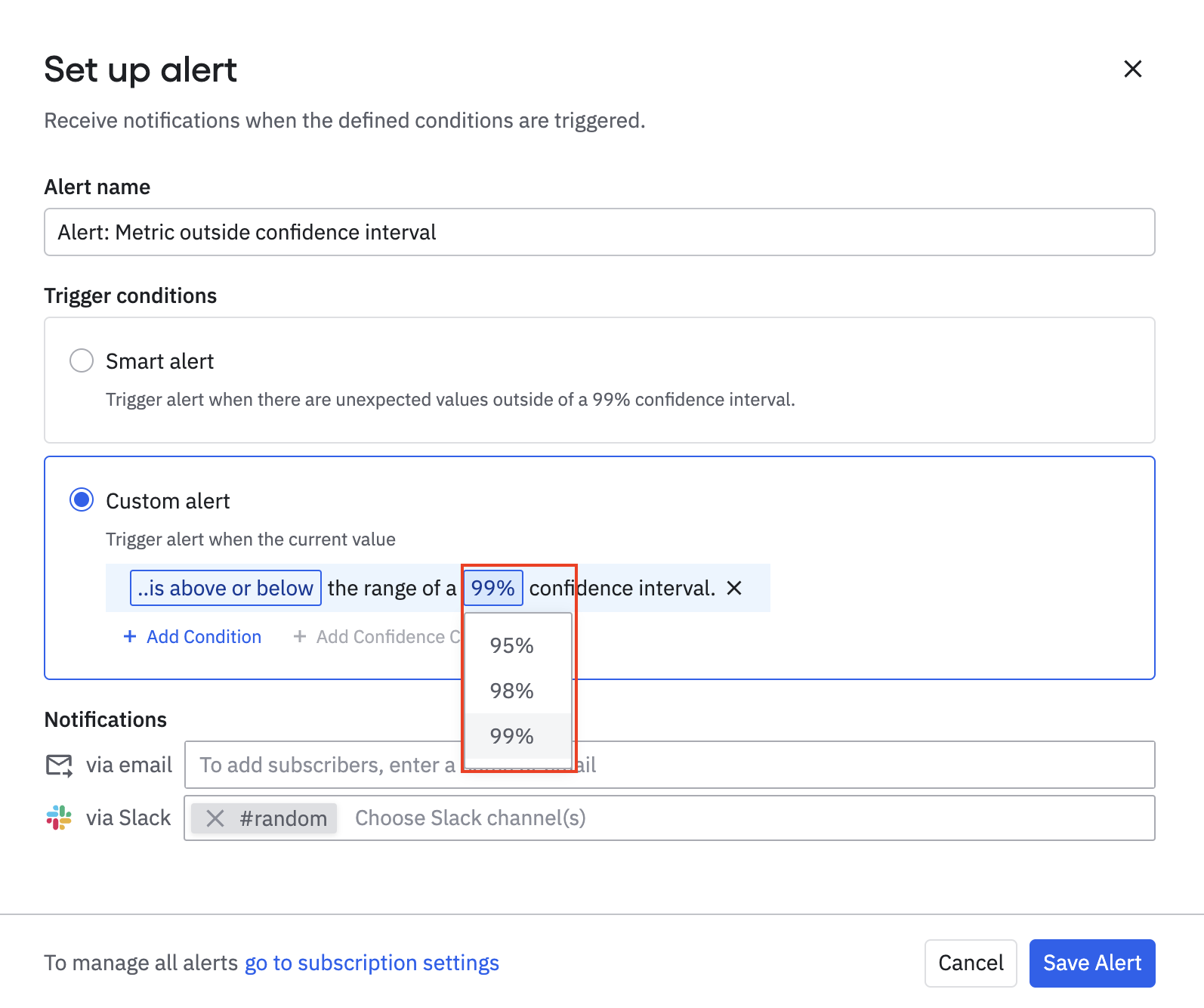

When you set up a custom alert, choose to receive alerts when the value breaches significance thresholds of 95%, 98%, or 99%. Amplitude determines these confidence intervals by taking your historical data and identifying where 95%, 98%, and 99% of all data points fall.
The higher the required significance, the less "noisy" your alerts are. In charts, the blue band represents the range of the confidence interval. A 95% confidence interval has a narrower band than a 99% confidence interval, because the 99% confidence interval captures more historical data points.

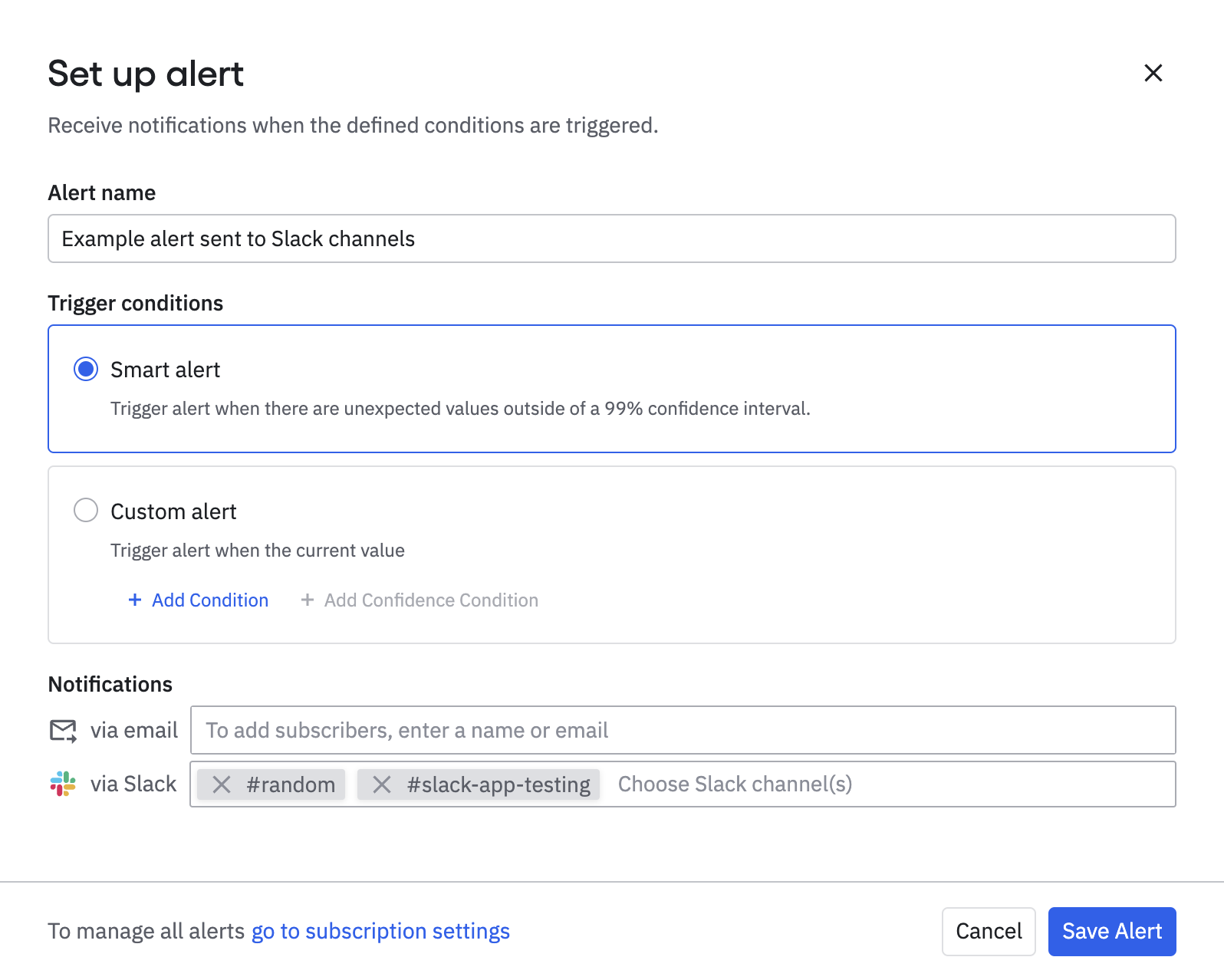

You can also set up an alert to post to one or more Slack channels.
When you configure or modify an alert, you can select Slack channels in the Notification section at the bottom of the modal.

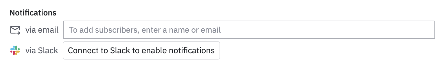

If you haven't set up the Slack integration, connect your Amplitude account by clicking the Connect to Slack button:
