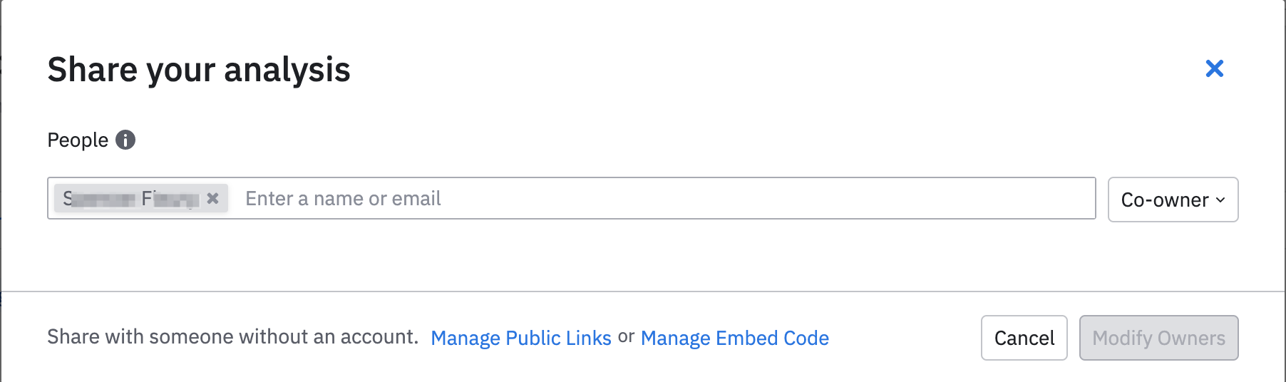

To share your chart, either click the link icon to copy the chart's URL to your clipboard, or click the share icon to open the Share your analysis modal.
Enter the names or emails of the stakeholders you want to share the chart with, and set their access privileges with the drop-down to the right. When you're ready, click Modify Owners.
