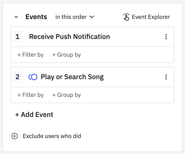

Sometimes, you may need to create an analysis in which a particular step of the process can be any of a selection of specific events.
You can combine multiple events in-line through the Events Module. However, the in-line event that you create is relevant to that specific chart and isn't accessible anywhere else unless you save it as a custom event. Custom events consist of two separate events joined by an OR clause. For example, this analysis shows in users who, after receiving a push notification, either played a song or searched for one as their next step:
You create a custom event in the Events panel from one or more pre-existing events. Doing so tells Amplitude to combine for those pre-existing events and count any user activity for them as activity for the new custom event. This is useful if you want an easy way to track activity on related or similar events, like whether a visitor has fired either the view_landing_page_1 or view_landing_page_2 events.
In the image above, Play or Search Song is a custom event consisting of the Play Song event, the Search Song event, and an OR clause to connect the two. Any user who triggers either the Play Song event or the Search Song event has converted that second step.

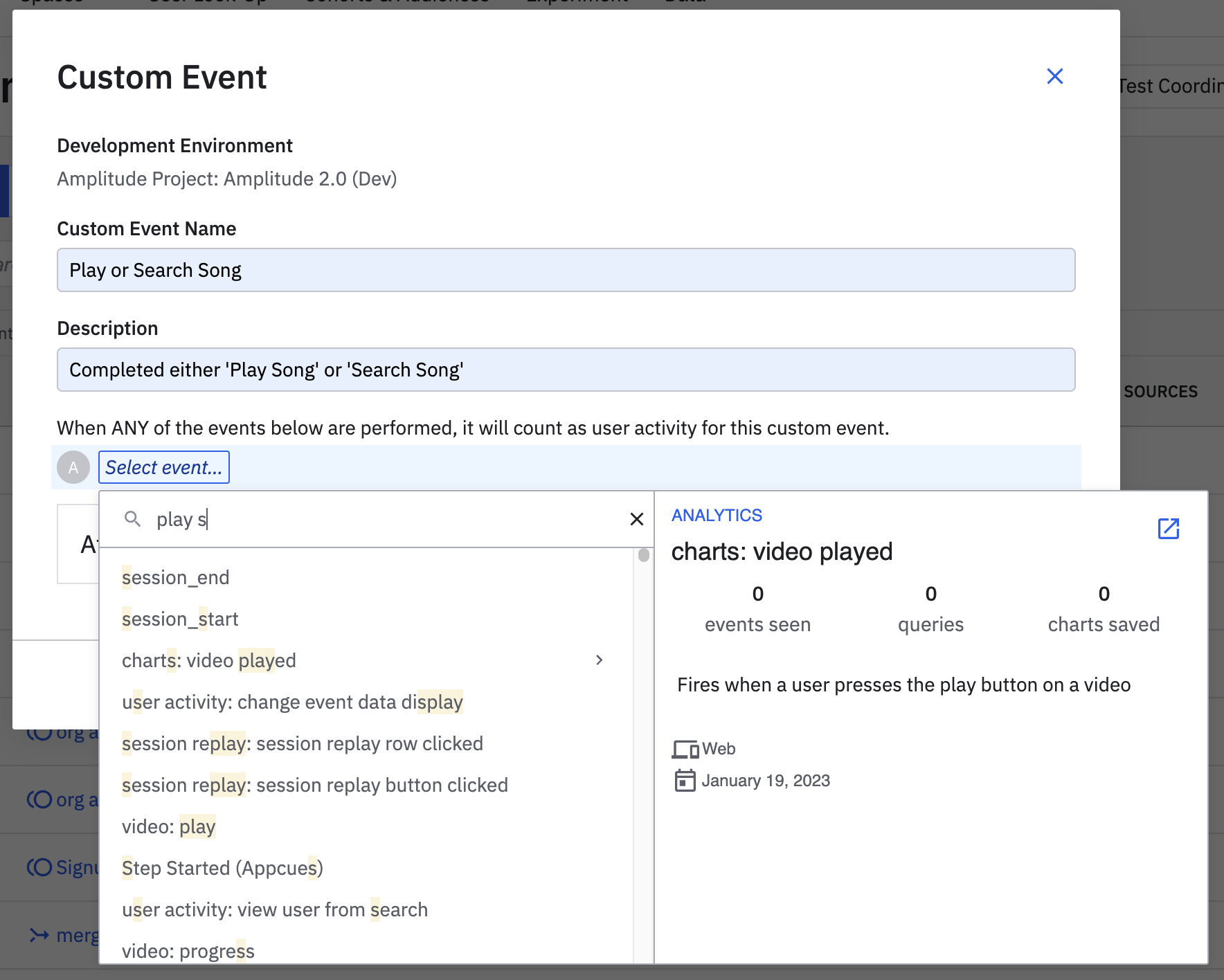

[Custom] before the event name in your charts.To do this, follow these steps:
In Amplitude Data’s left-hand rail, click Events. Then click Create Custom Event.
In the modal that appears, select the events you want to analyze as a single event. There is an option to set different filters on these events, in case the analysis requires a more granular view of the selected events.
At this point, this event is available for further analyses in Amplitude. To use it, select the new event in the Custom category in the appropriate chart drop-down menus.
