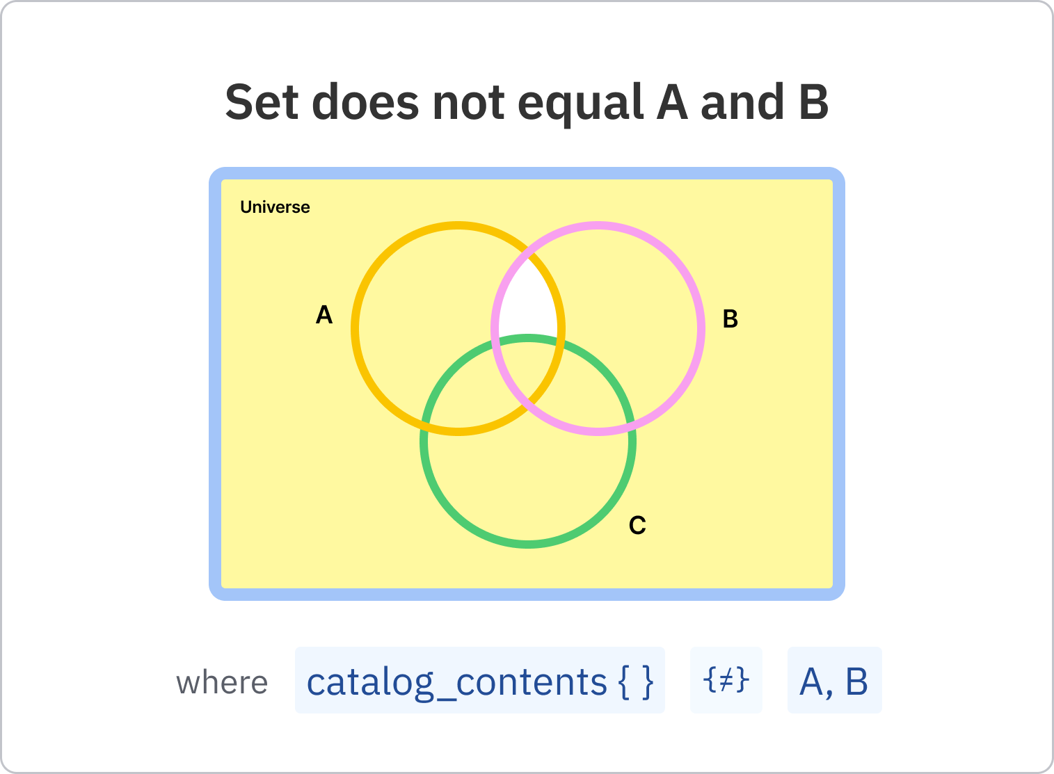

When building charts in Amplitude, deciding which array operators to use (is, is not, contains, does not contain, set is, set is not, set contains, set does not contain) can be confusing, especially for users who are new to Amplitude. The diagrams shown in this article are intended to serve as a visual aid in that process and help you quickly grasp the nuances of these operators.

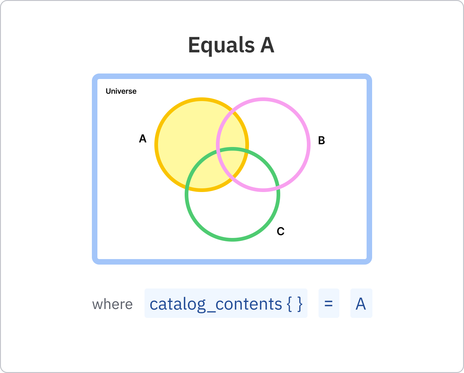

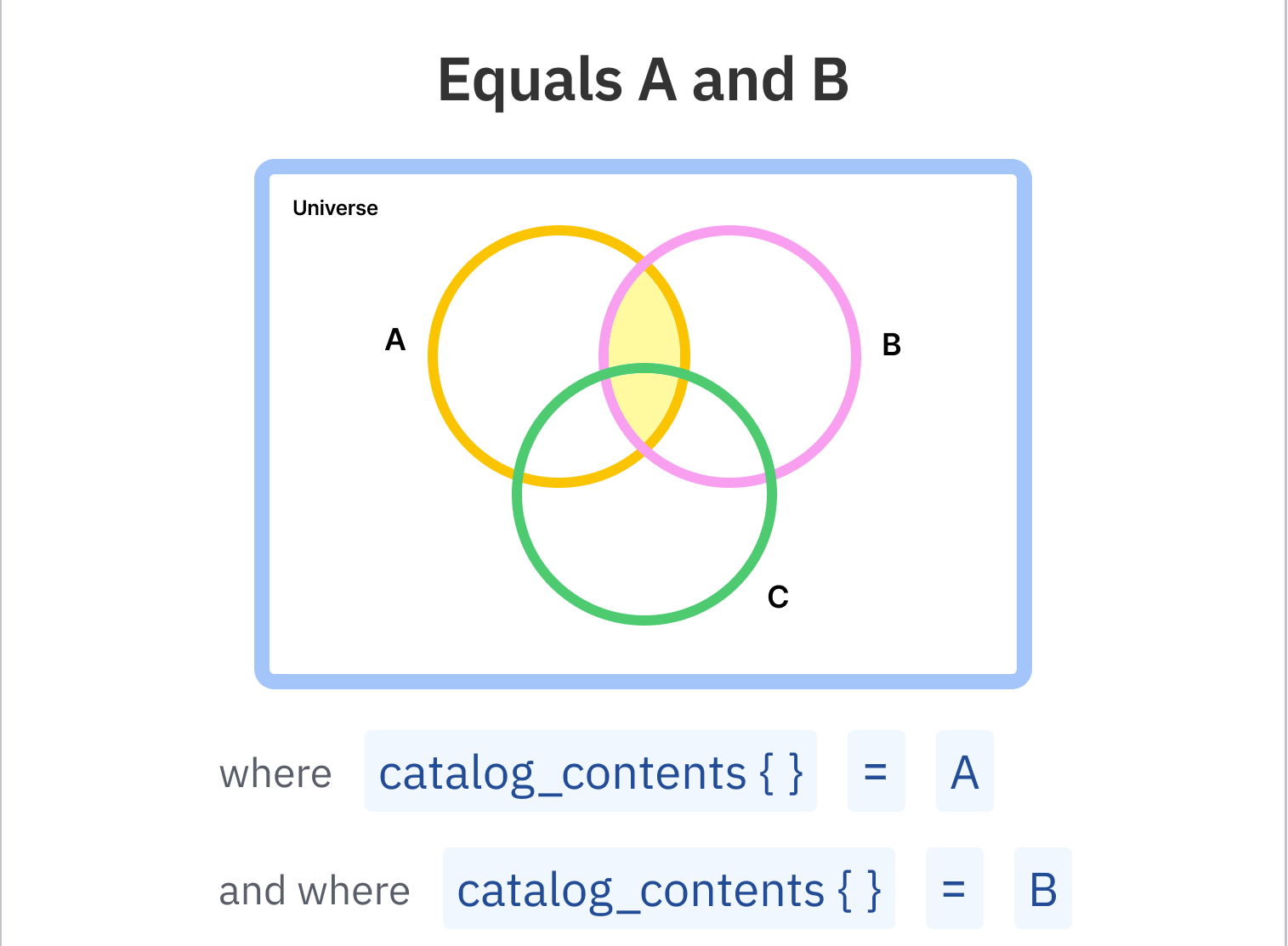

Equals

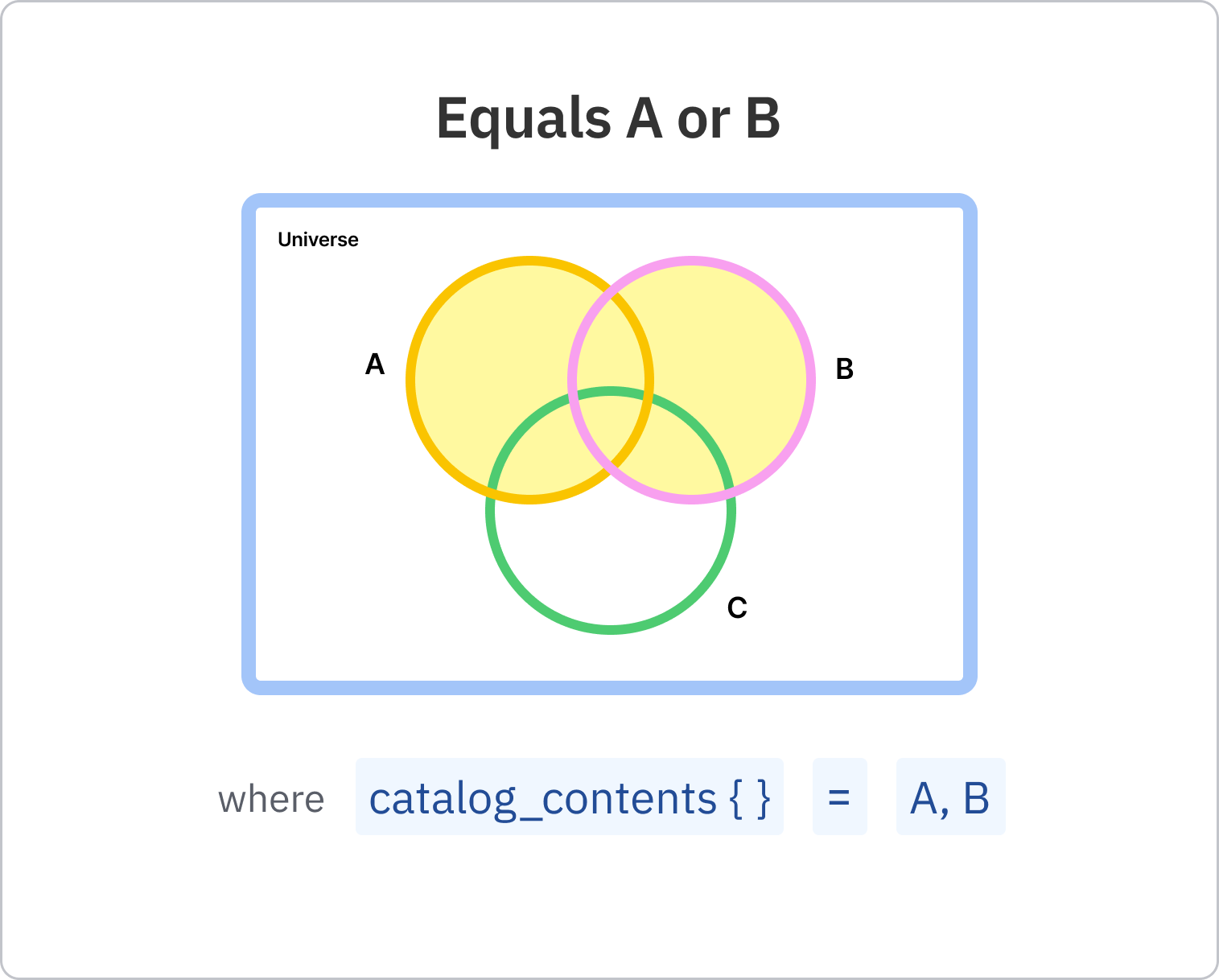

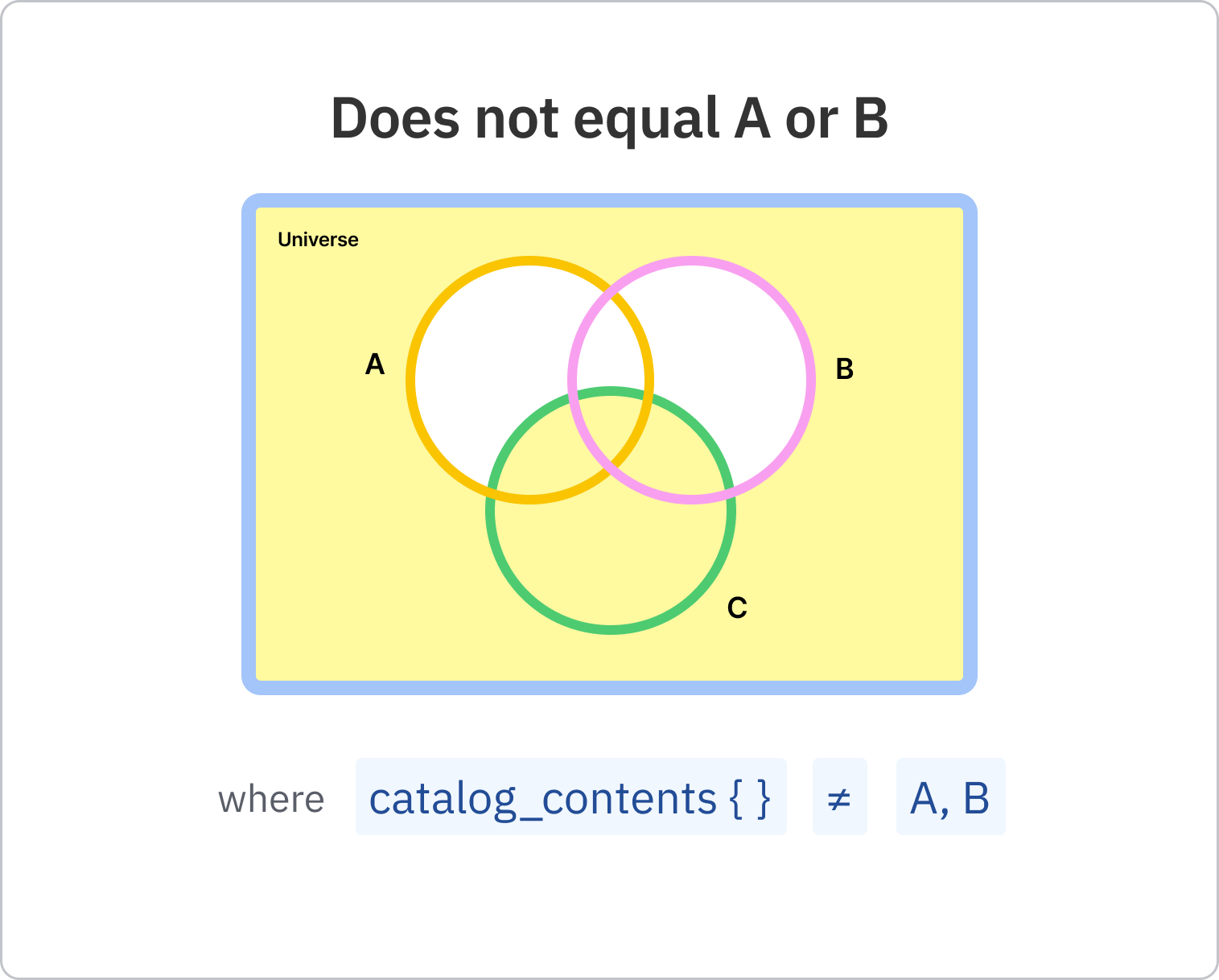

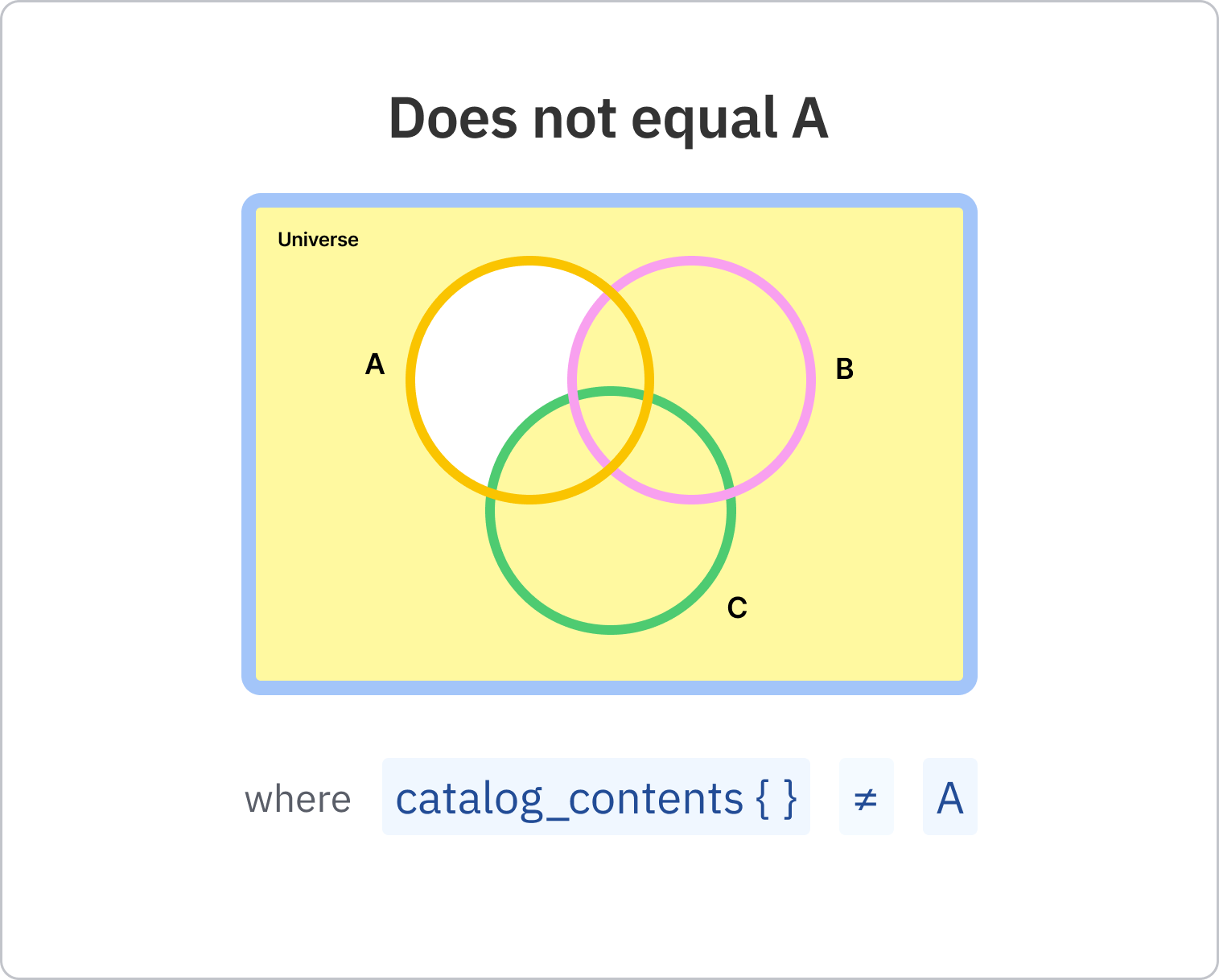

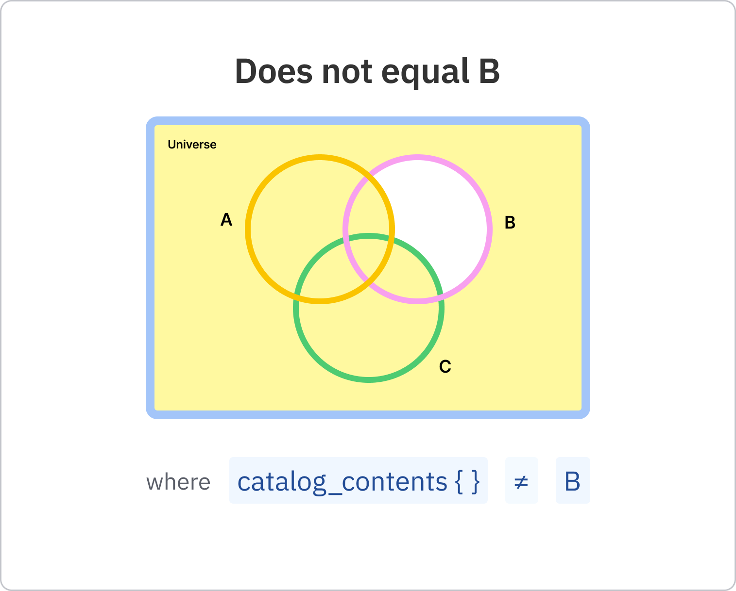

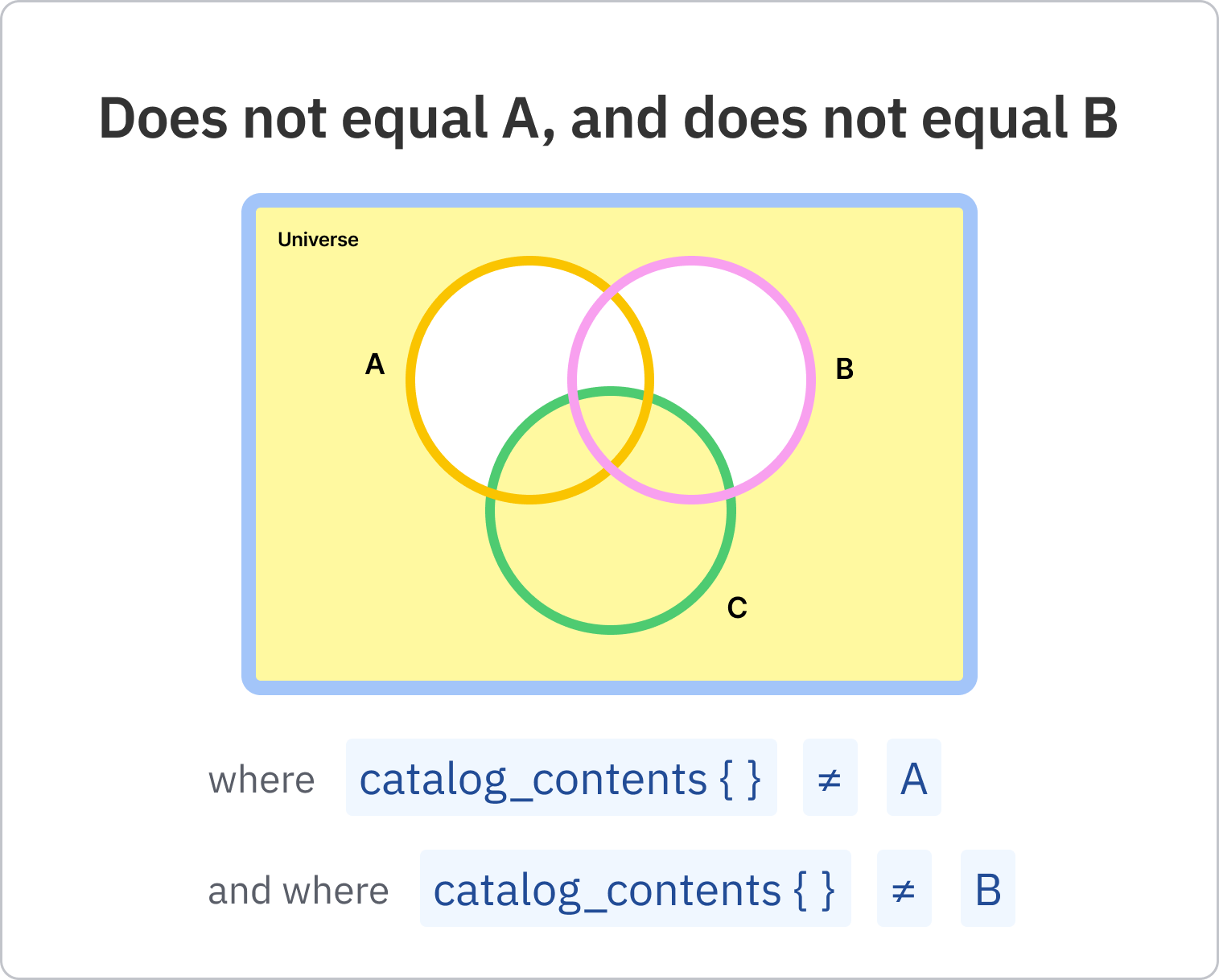

07_-_Does_not_equal_A_or_B.png    08_-_Does_not_equal_A__and_does_not_equal_B.png

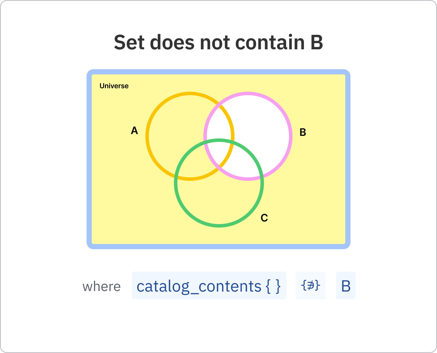

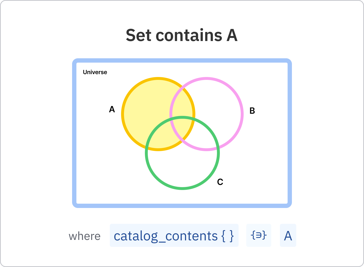

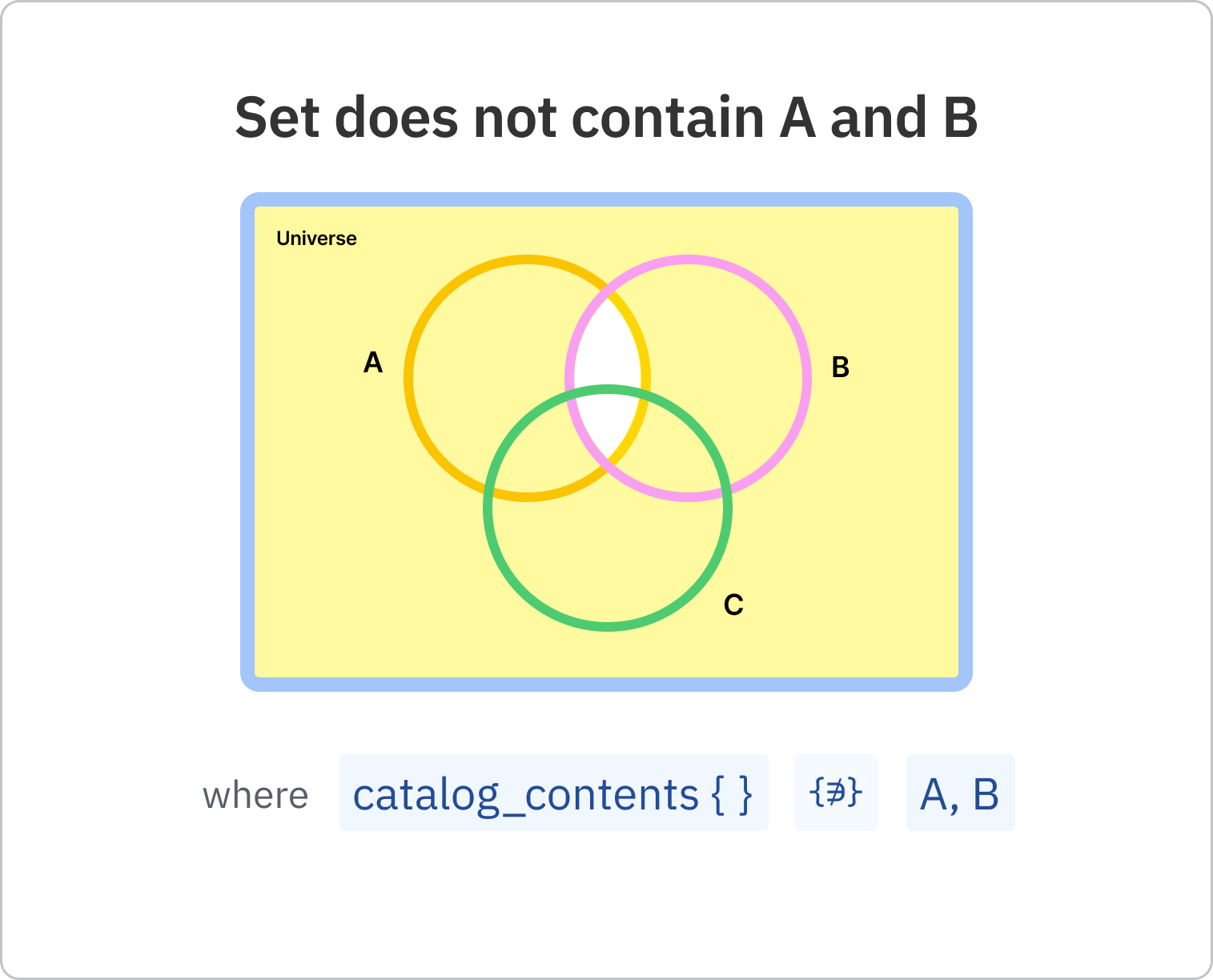

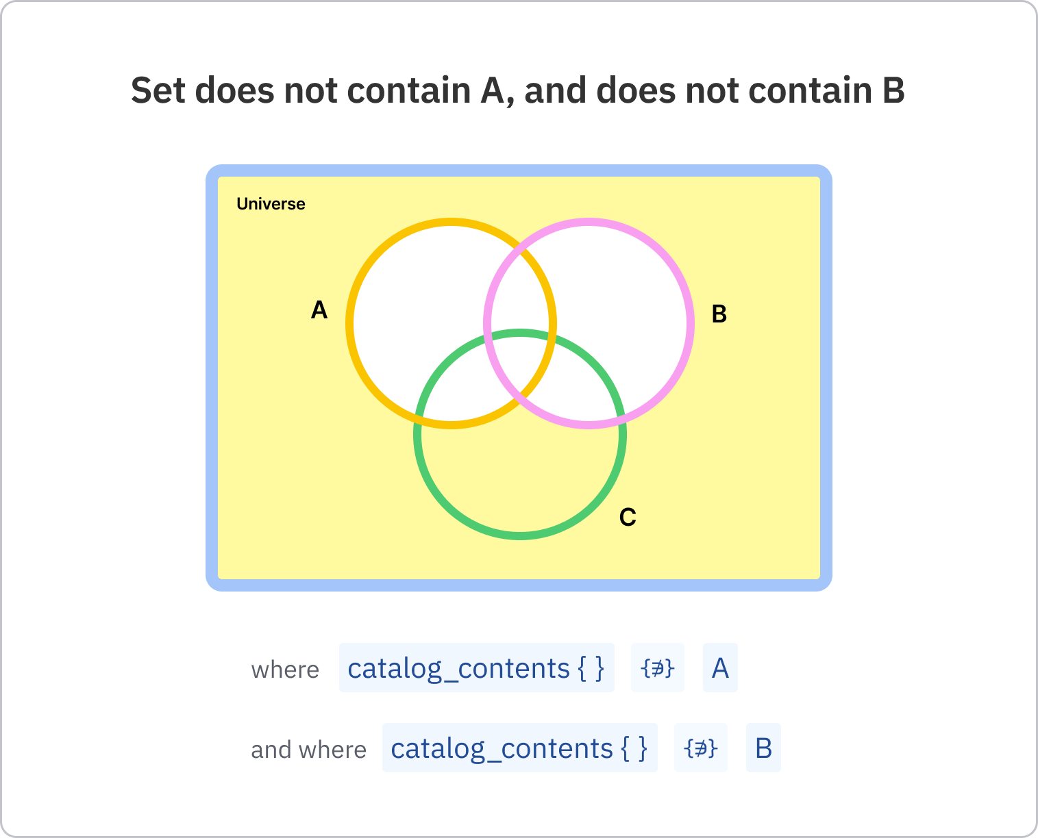

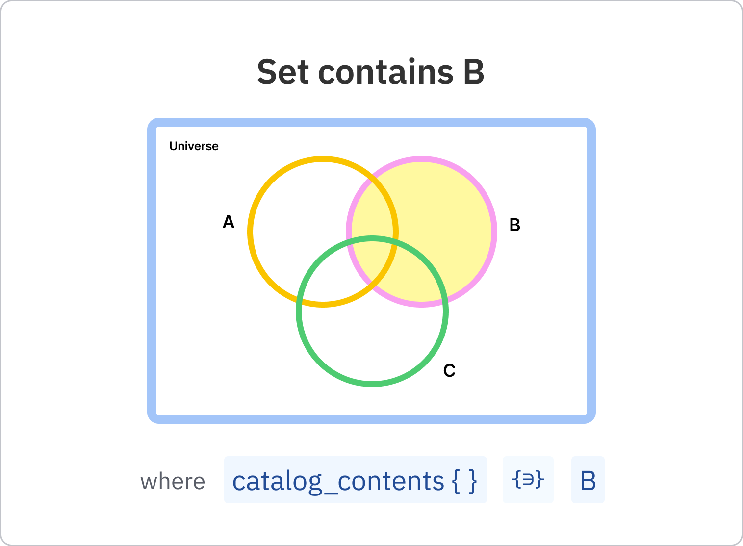

Set contains

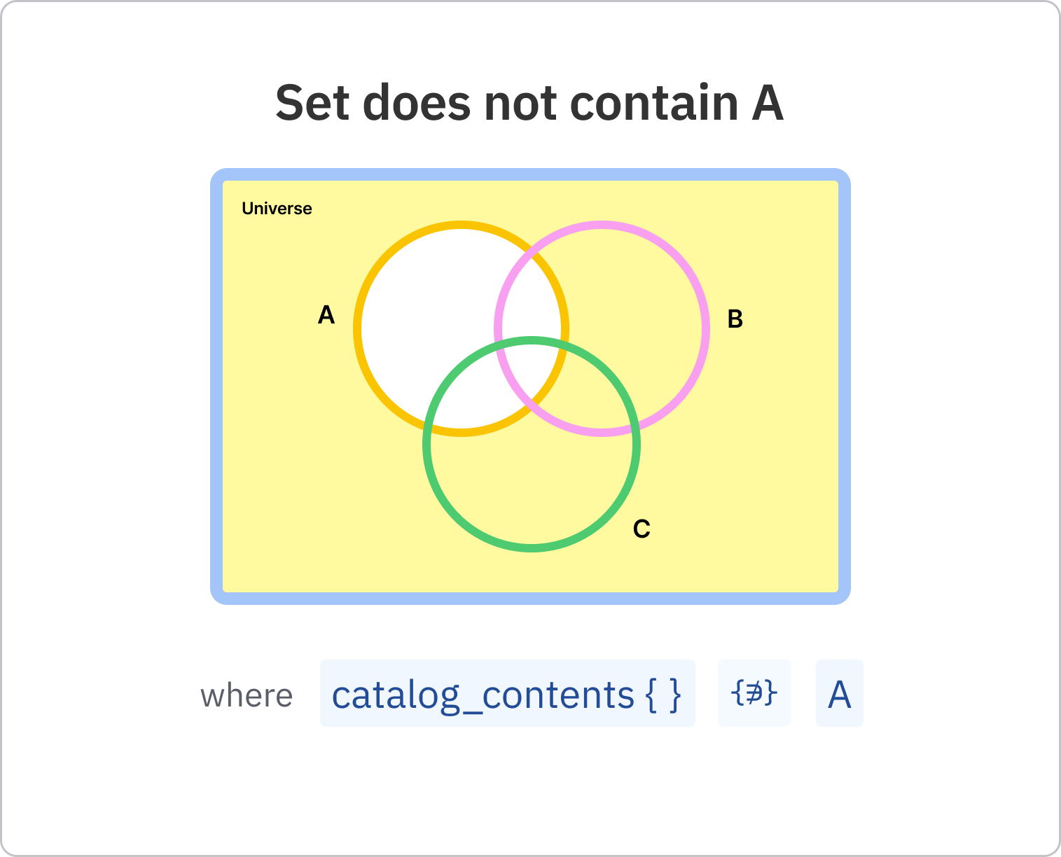

 14_-_Set_does_not_contain_A_and_B.png    15_-_Set_does_not_contain_A__and_does_not_contain_B.png

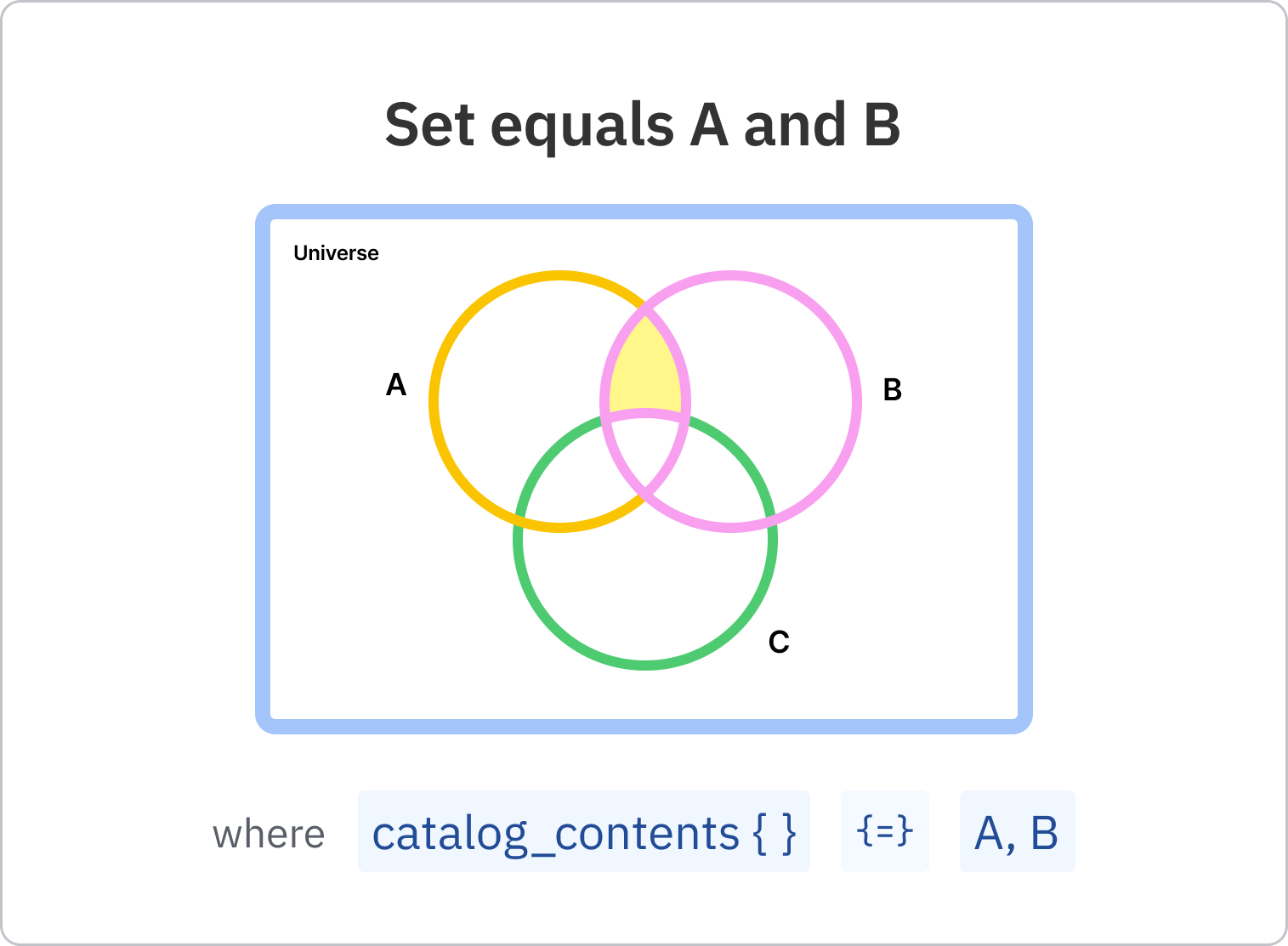

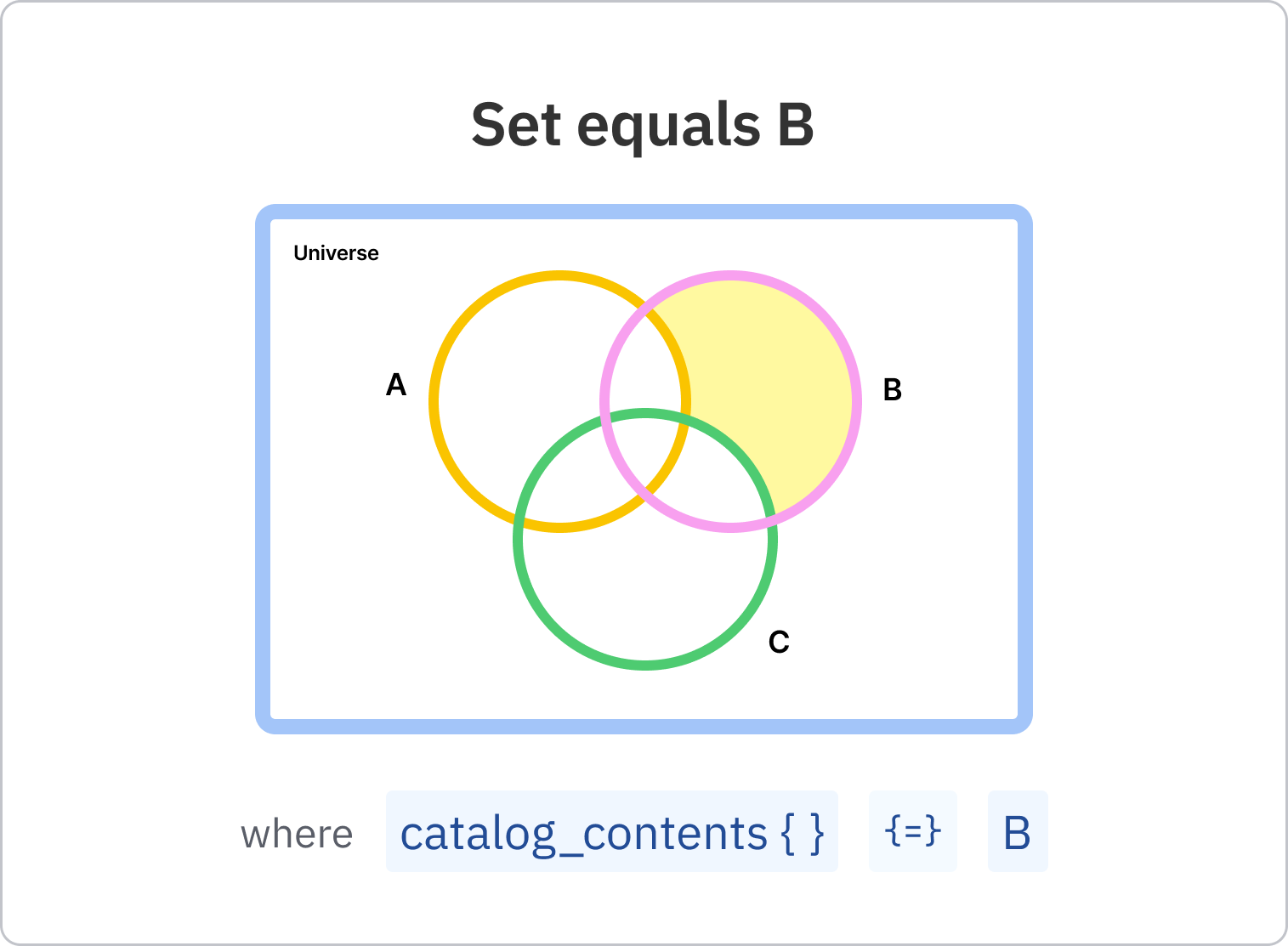

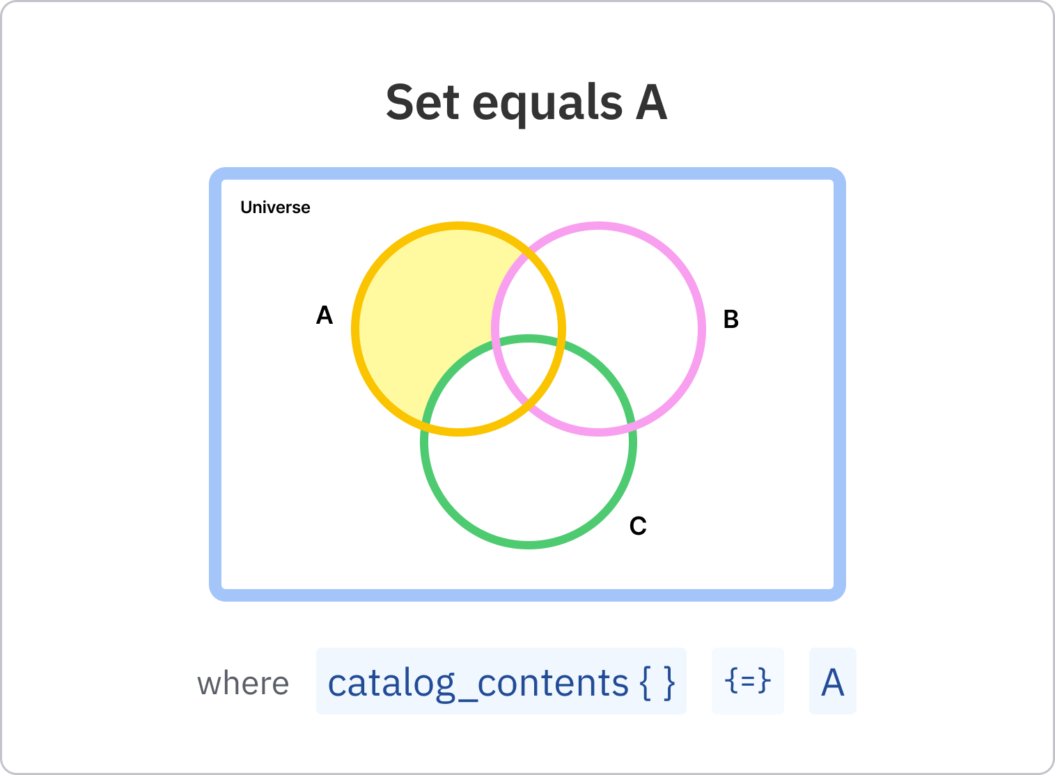

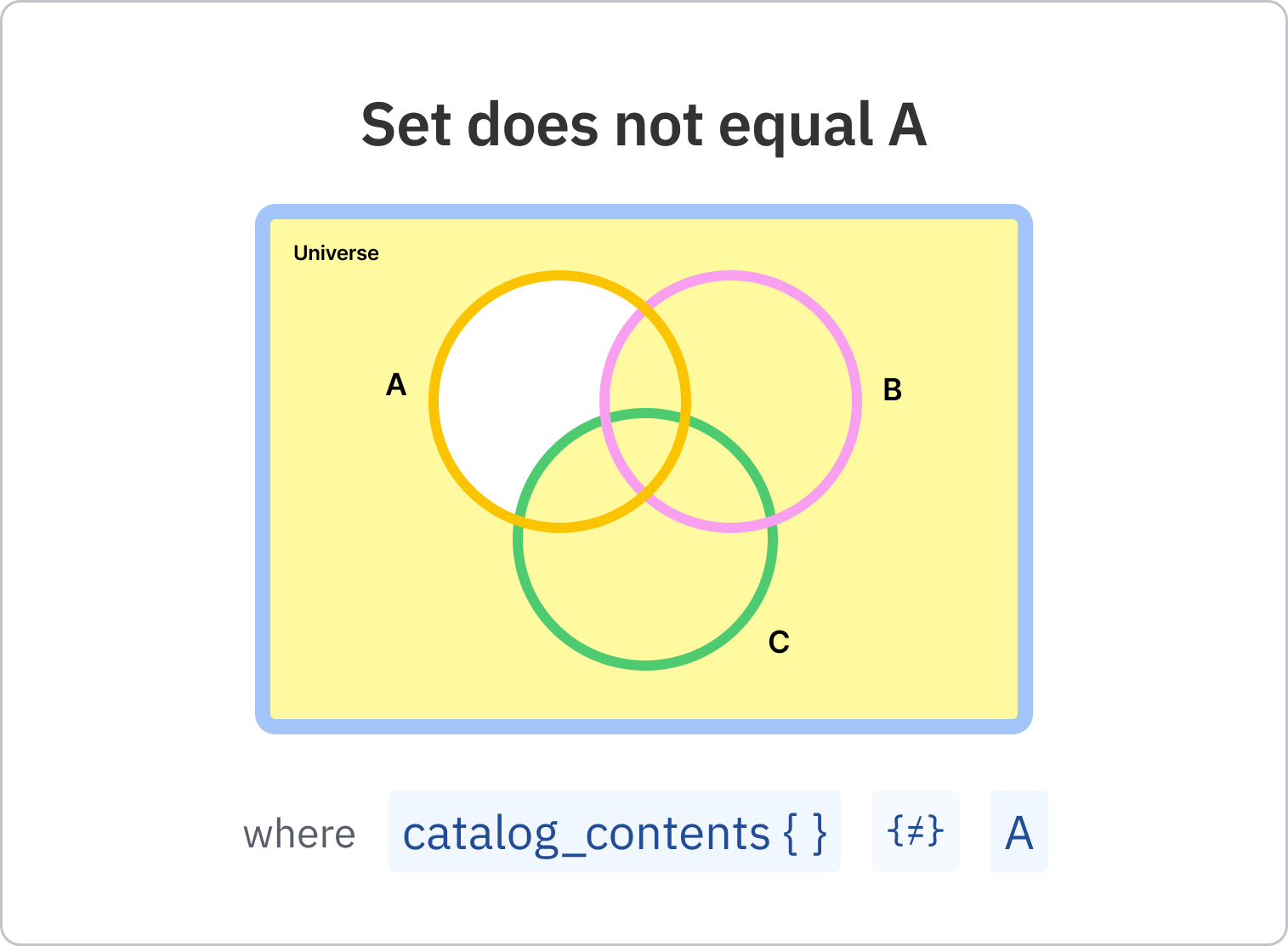

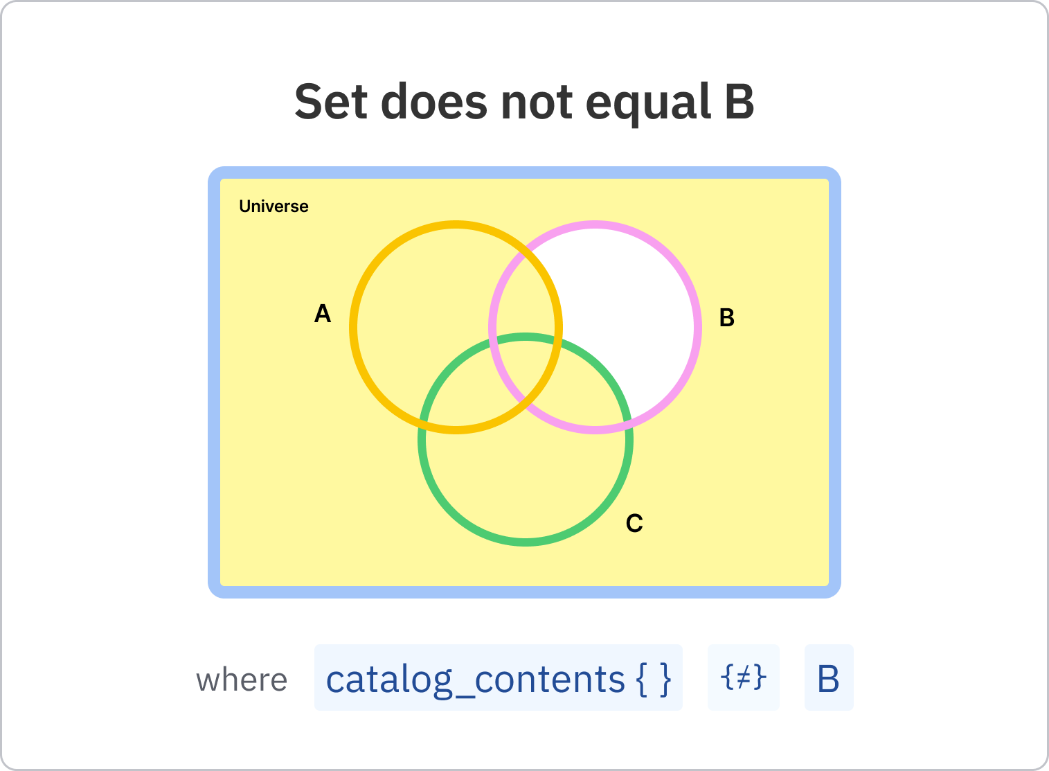

Set equals
