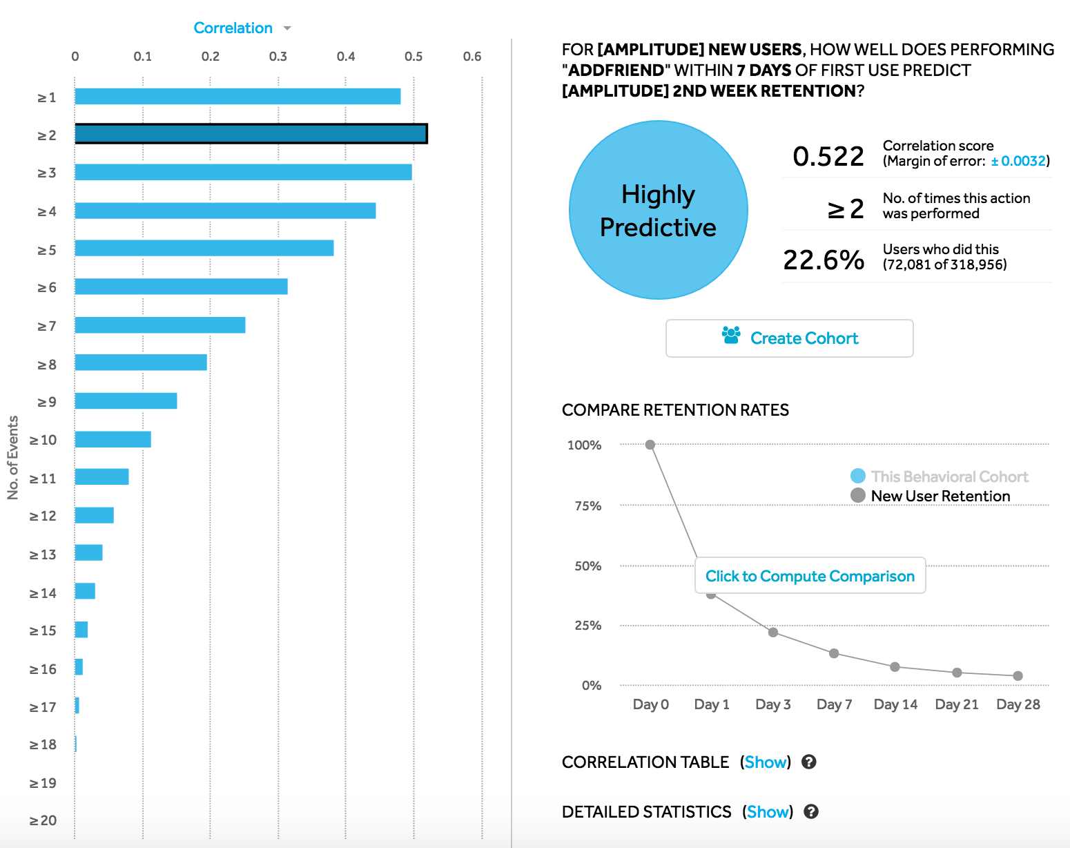

Compass is a powerful feature that can help you identify behaviors that are predictive of retention or conversion. It identifies inflection metrics, or those that capture the moments when a user has reached a critical threshold in your product—which are instrumental in driving user growth.
For example, Facebook found early on that adding seven friends in the first ten days was the strongest signal of long-term retention. More recently, Netflix published an analysis on exactly how many episodes it takes per TV show to get hooked on the show.

The proportion above threshold tells you how many new users actually triggered the event in their first N days. This matters because there must be a large enough sample of users meeting the threshold for Compass to understand how well it correlates with retention.
One way to change the proportion is by increasing the number of performance days in the window (Amplitude allows between one to seven days). More performance days gives users more time to reach the threshold, hence increasing the proportion. If you are investigating an event property, consider looking at the complete event, as that may have a high enough proportion above the threshold.
There's no perfect proportion above the threshold. Too low and it's unlikely you can get new users to perform that event that many times; too high and you don't have any room for improvement.
There are some extreme cases where a low proportion above the threshold can still result in a high correlation. For example, if a web application has high traffic but forces login for all new users.
This metric is important because it takes into account the balancing of finding your inflection metric. Referring back to the Facebook example, getting a new user to add one friend isn't a great choice for an inflection metric, because most users do that. However, getting a new user to add 100 friends, while highly correlated with retention, is hard because a very low percentage of users actually reaches that level.
If you have a reasonable proportion above the threshold, view the correlation between reaching the event frequency and retention. Do this by looking at the positive predictive value (PPV) and sensitivity.
