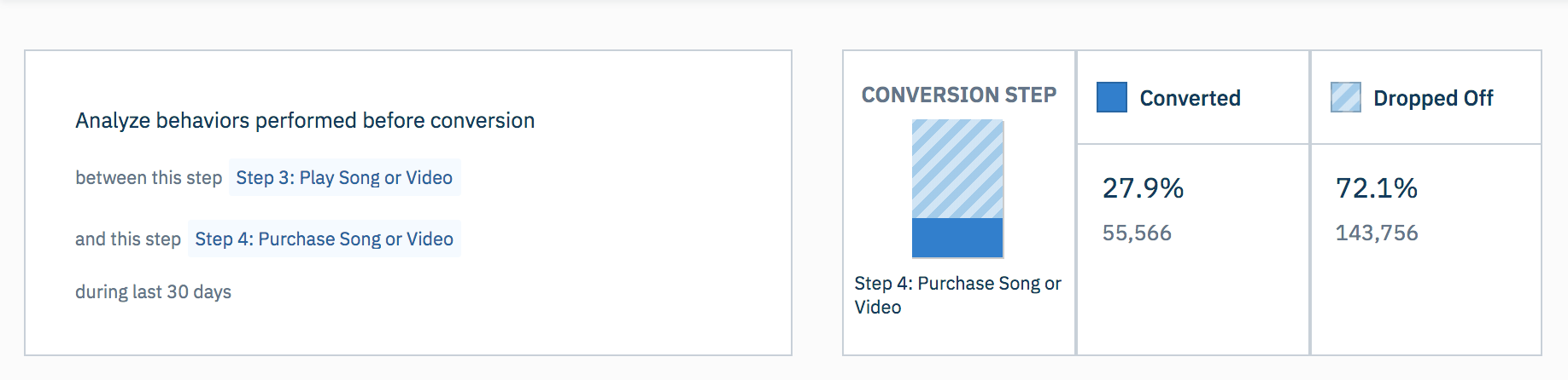

A conversion drivers analysis begins with a simple, two-step funnel. Step one should be the starting event—for example, Search Song or Video in a music app—while step two should be the conversion event you’re interested in, like Purchase Song or Video. Amplitude will then automatically sort through, aggregate, and analyze all events that occur for each user between these two steps, in order to identify which user actions are most strongly correlated with that outcome.

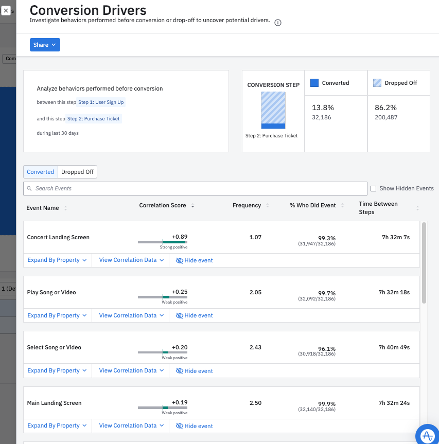

The conversion drivers panel has two sections. The step controller gives you the option to choose the beginning and ending steps for your conversion driver analysis. You can change these by clicking on them and selecting the events you’re most interested in.
This section also displays the conversion and drop-off numbers for the steps you’ve selected, in terms of both unique users and a percentage of users.

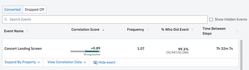

Below the step controller is the events table. This lists all the events users have performed between the two selected steps. At the top of the table, you can choose to look at the event list either for users who converted, or for users who dropped off.
The events table shows four relevant metrics for each event listed:
For users who convert, Amplitude looks at the events performed between the timestamps of the two selected funnel steps. For users who churn, Amplitude looks at the timestamps of the first selected funnel step, and their entry into the funnel plus the conversion window.

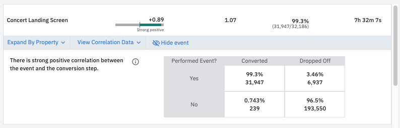

Correlation is a measure (ranging from -1 to 1) of how two variables relate to each other. In a conversion drivers analysis, the variables for each user are:
Click View Correlation data for a detailed confusion matrix (aka, prediction summary). This matrix shows the count and percentage of users in your base cohort who constitute:
You may have heard of different variations and definitions of correlation, including Matthews correlation, Pearson correlation, phi coefficient, and R-value. In this case, all these definitions are equivalent because a conversion drivers analysis looks at pairs of binary random variables.

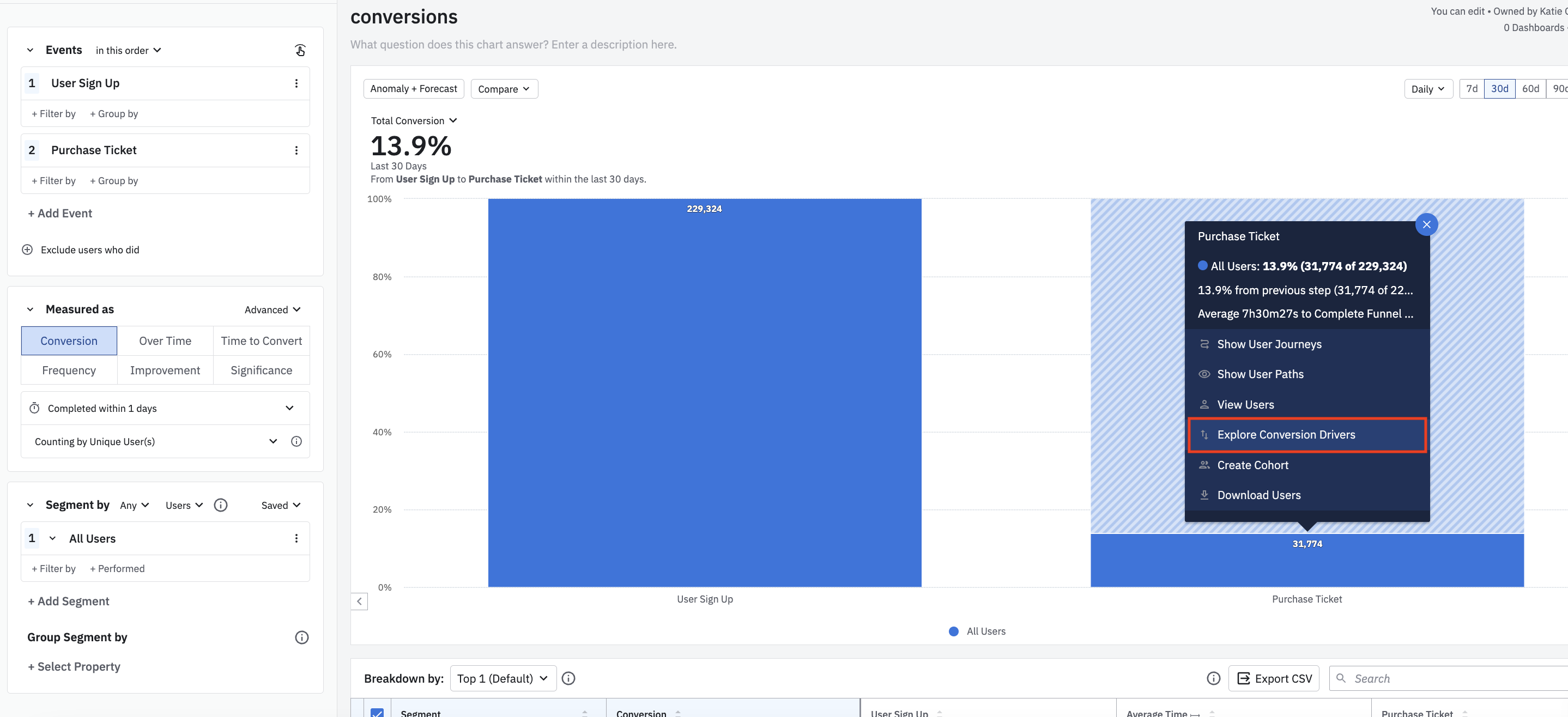

To use this feature, open a funnel chart and follow these steps:

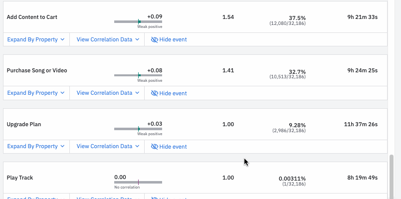

The conversion drivers tab lists every event included in your project, along with each event’s correlation with either conversion or churn. In this example, the Add Content to Cart event is very highly correlated (+0.97) with conversion on the Purchase Song or Video event.
