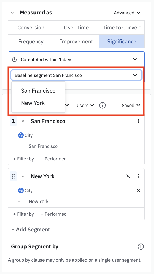

Amplitude, by default, uses the first segment added to the funnel analysis as the baseline, but you can change this in the Baseline segment drop-down menu.
