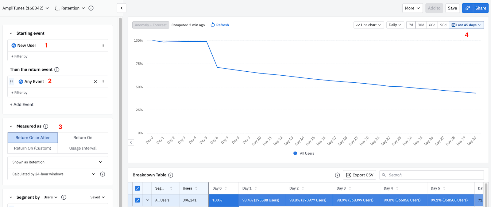

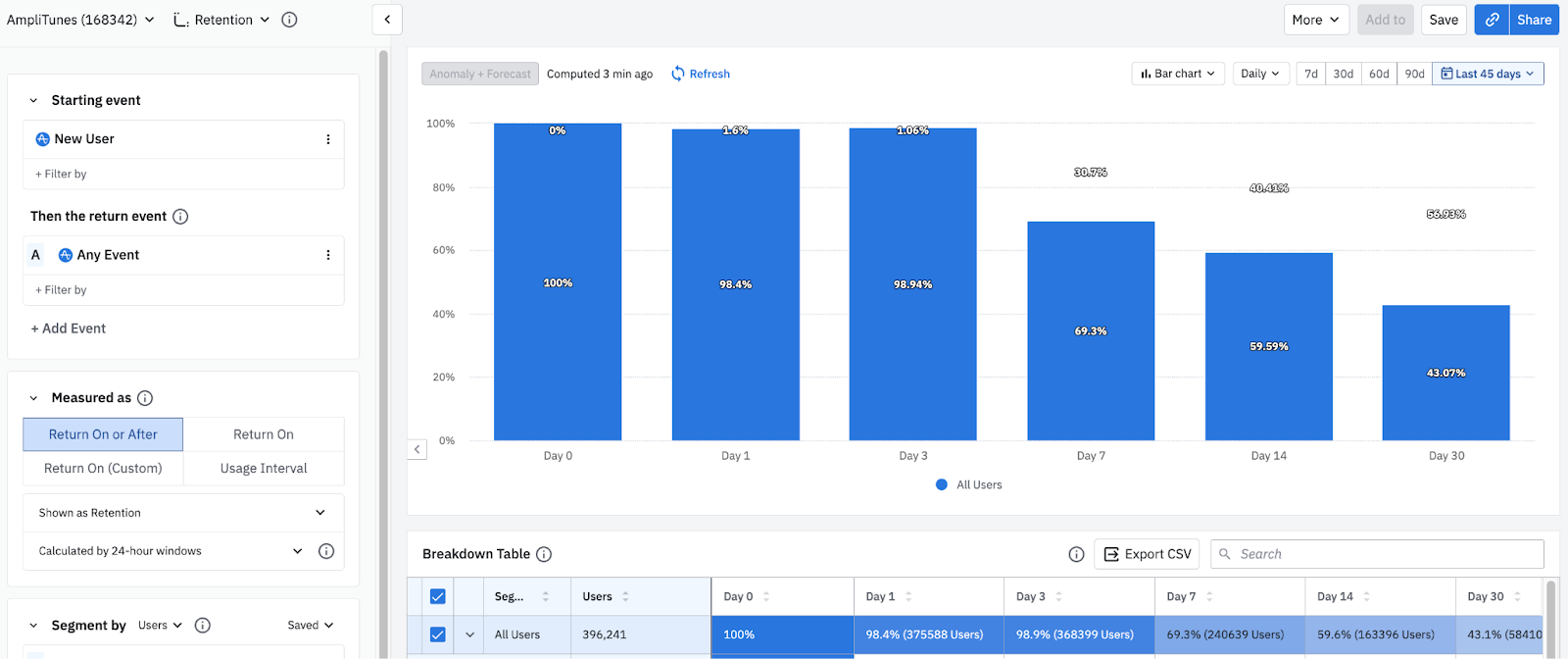

Interpreting your Retention Analysis chart is more straightforward than it may at first appear, mostly because you can read through the parameters like a sentence. For example, the following chart shows you (1) new users who came back and triggered (2) any event (3) on or after the first day of your retention analysis over (4) the last 45 days:
All these parameters can be easily changed to reflect the needs of your analysis.

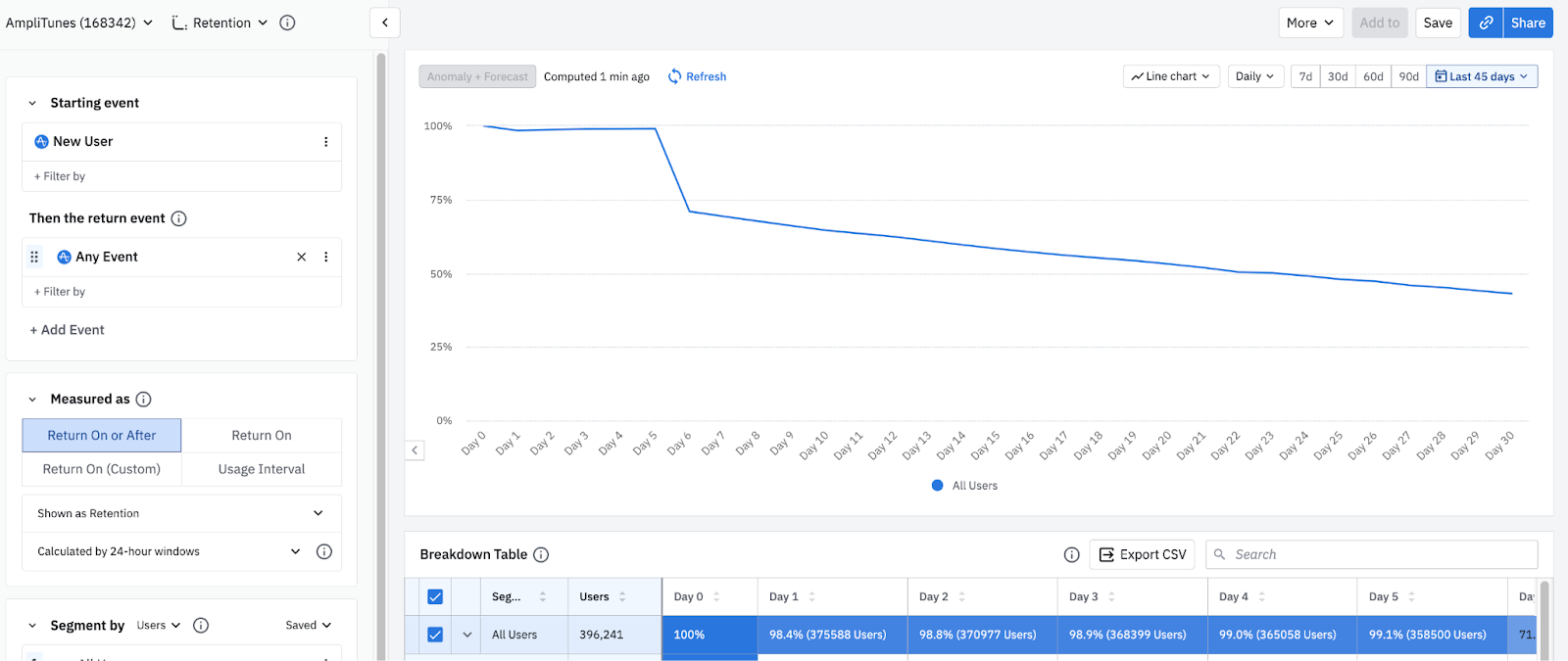

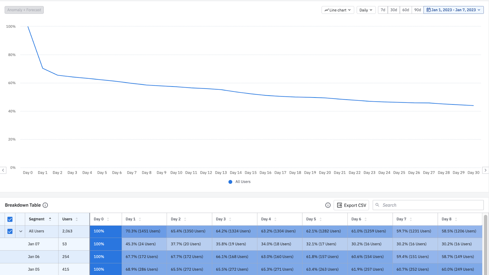

Return On or After retention tells you how many of your users triggered your return event on a specific day or after they triggered your starting event. When using Return On or After, the retention value for Day 7 tells you the percentage of users who returned seven days or more after their first use.
When you first open the Retention Analysis chart, the Return On or After retention graph by default shows retention for new users who returned any event. To see exact percentages, hover over the data point for the day you’re interested in, or click it to inspect the users at that interval (see the Help Center article on Amplitude’s Microscope feature to learn more).
To see this data as a bar chart, click the Line chart dropdown. You can still use Microscope to get more details on users who weren't retained.

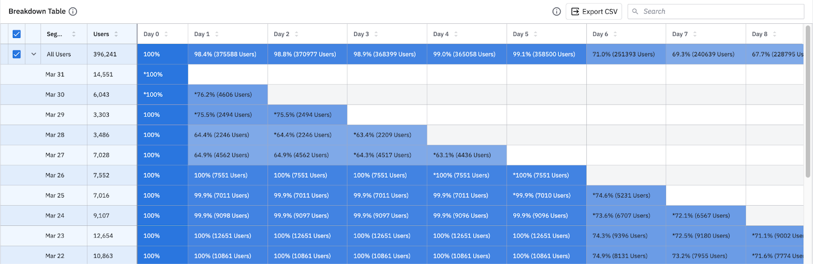

Amplitude also displays a detailed table breaking down the data, broken out by each user cohort and into individual day buckets.
The method Amplitude uses to calculate Return On or After retention depends on whether you’re looking at retention for all users, or for a specific cohort entry date for your segment. Both the chart and the first row of the breakdown table below it show overall retention by default.

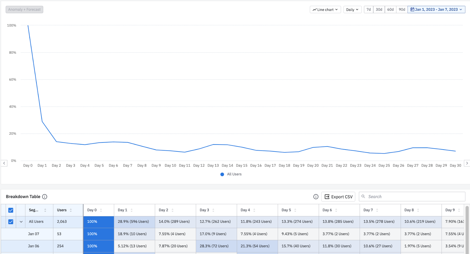

Return On retention tells you the percentage of users that came back to trigger your return event on a specific day after triggering your starting event. The retention value for day 7, for example, tells you the percentage of users who returned on day 7 after their first use.
Regardless of whether you are looking at retention for all users or for specific cohort entry dates, Amplitude uses only one method to calculate Return On retention (unlike Return On or After). Both the chart and the first row of the breakdown table below it show overall retention by default.

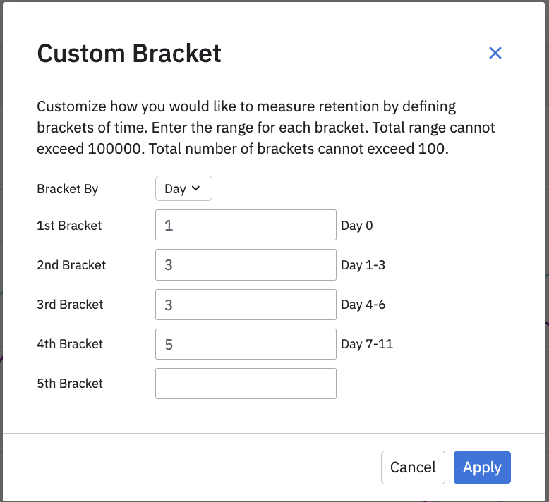

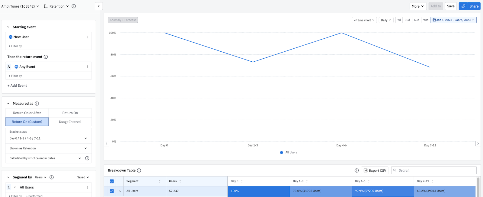

By default, Amplitude assumes you’ll want to use predefined units of time — days, weeks, months, etc. — as retention brackets for your retention analyses. But you can change this by using Return On (Custom) and instead create custom brackets for your Return On retention.
Because the custom brackets feature uses the same logic as Return On retention, you can use it to generate the equivalent of a Return On retention chart while defining the relevant units of time yourself.
In the image above, there are four custom brackets defined:
The line graph shows the weighted averages of all the bracket retention numbers from the user cohorts within the selected timeframe.

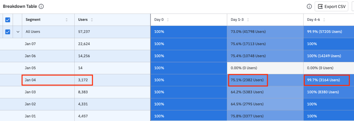

In the table below, on Jan 4th there were 3,172 new users:
The Day 1-3 retention is 75.1%, meaning that 2,382 of the 3,172 users triggered the return event anywhere between one and three days after their starting event.
The Day 4-6 retention is 99.7%, meaning that 3,164 of the 3,172 users triggered the return event four to six days after their starting event.
Each chart can have a maximum of 100 custom brackets. Results for days with incomplete data show an asterisk.

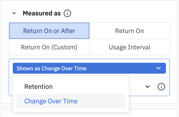

Sometimes you may need more than a straightforward view of your retention rates on specific days. You might want to know how a new release has affected your product’s Day 1 retention rates, or if a new training program has had an impact on your Day 14 retention rates. In these cases, you can view your retention data over time, by selecting Change Over Time from the Shown as dropdown.

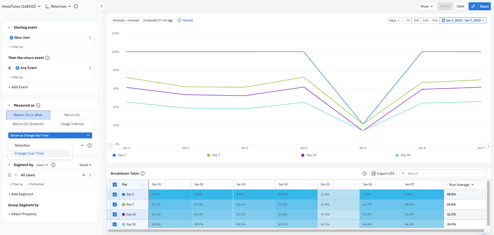

In this chart, we’re looking at all users who were new on January 1st. 100% of them triggered the return event on Day 1, and 72.1% triggered it on Day 7.
Amplitude calculates this percentage by dividing 1) the number of users from each new user cohort who triggered the return event on each retention day, by 2) the number of users who were new on the selected day.
