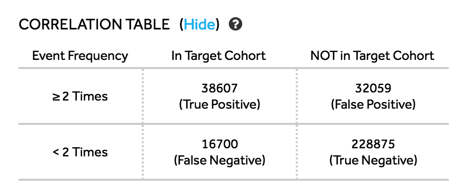

Clicking Show (next to Correlation Table) will bring up a detailed contingency table that shows the count of users in your base cohort in each of four categories: true positives, false positives, false negatives, and true negatives.

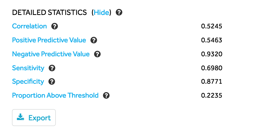

Likewise, you can see detailed statistics on your cohort by clicking Show (next to Detailed Statistics):
You can read more about these statistics here.
