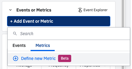

  1. Navigate to where you'd add an event to your analysis. Then open the Metrics tab and click + Define new Metric.

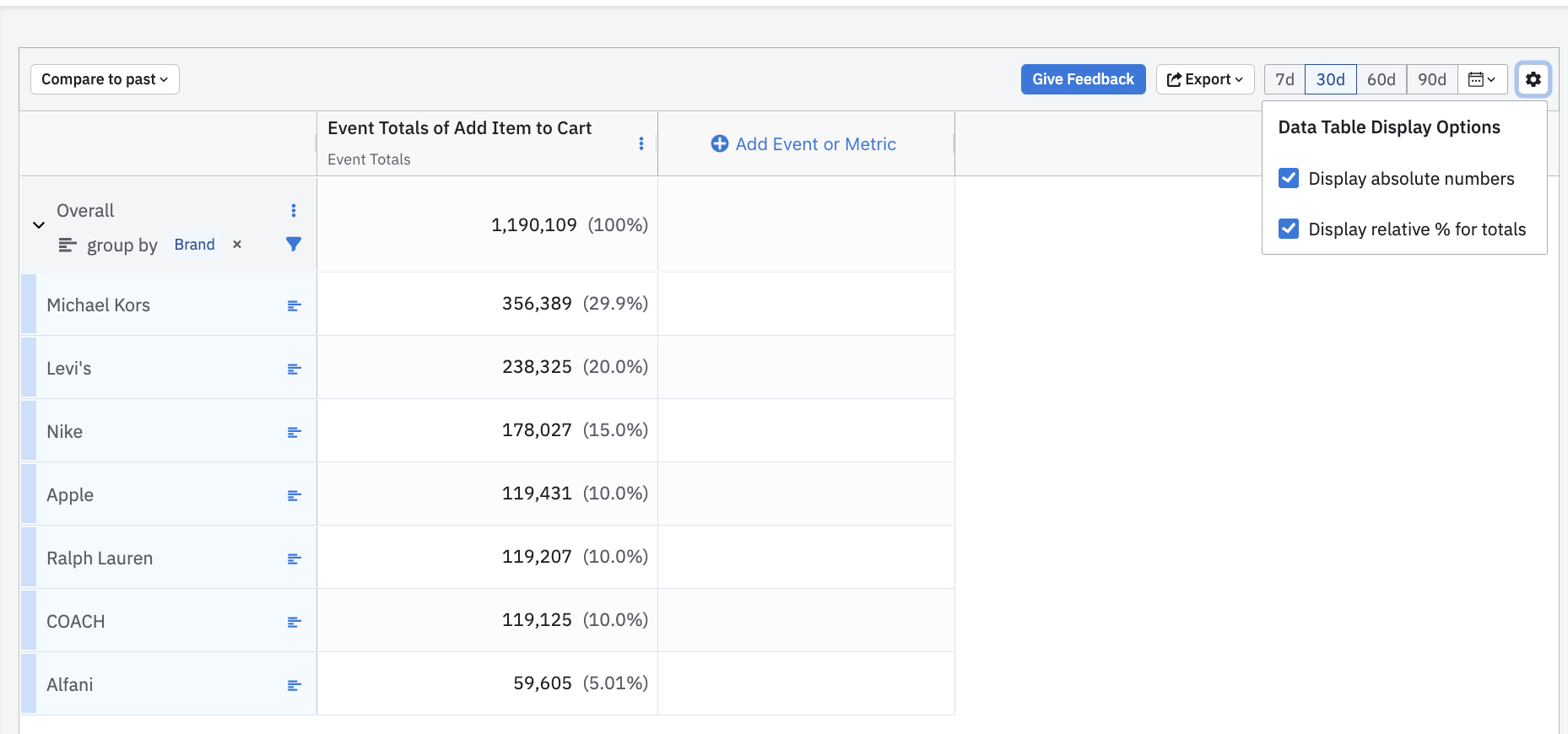

For event total metrics in Data Tables, click on the settings gear next to the date picker to toggle between absolute numbers, relative percentage of total, or both visualization options.
