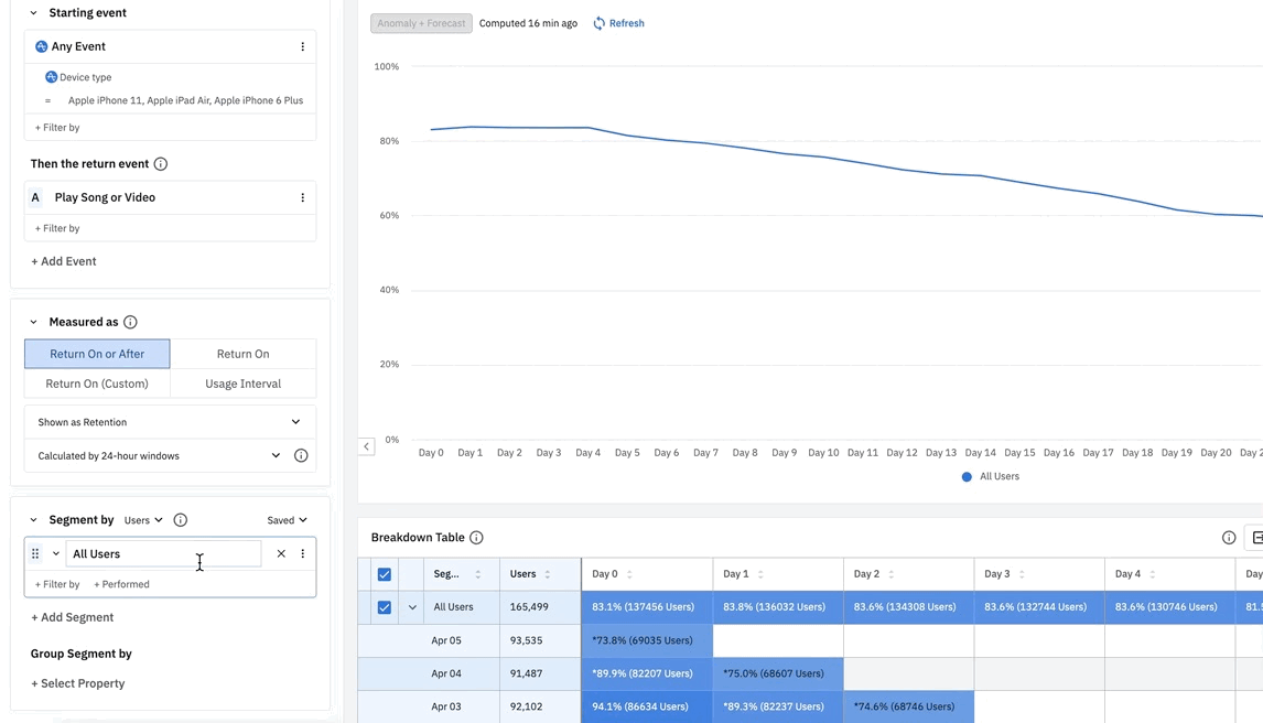

Amplitude computes retention data by comparing the date of that starting event to the date of the return event you’ve specified. The return event is the event that, when triggered, tells you a user has been retained. When building a retention analysis chart, you can choose any event you like for both the starting and return events. You can also opt not to choose a specific event, and instead tell Amplitude to use any active event.

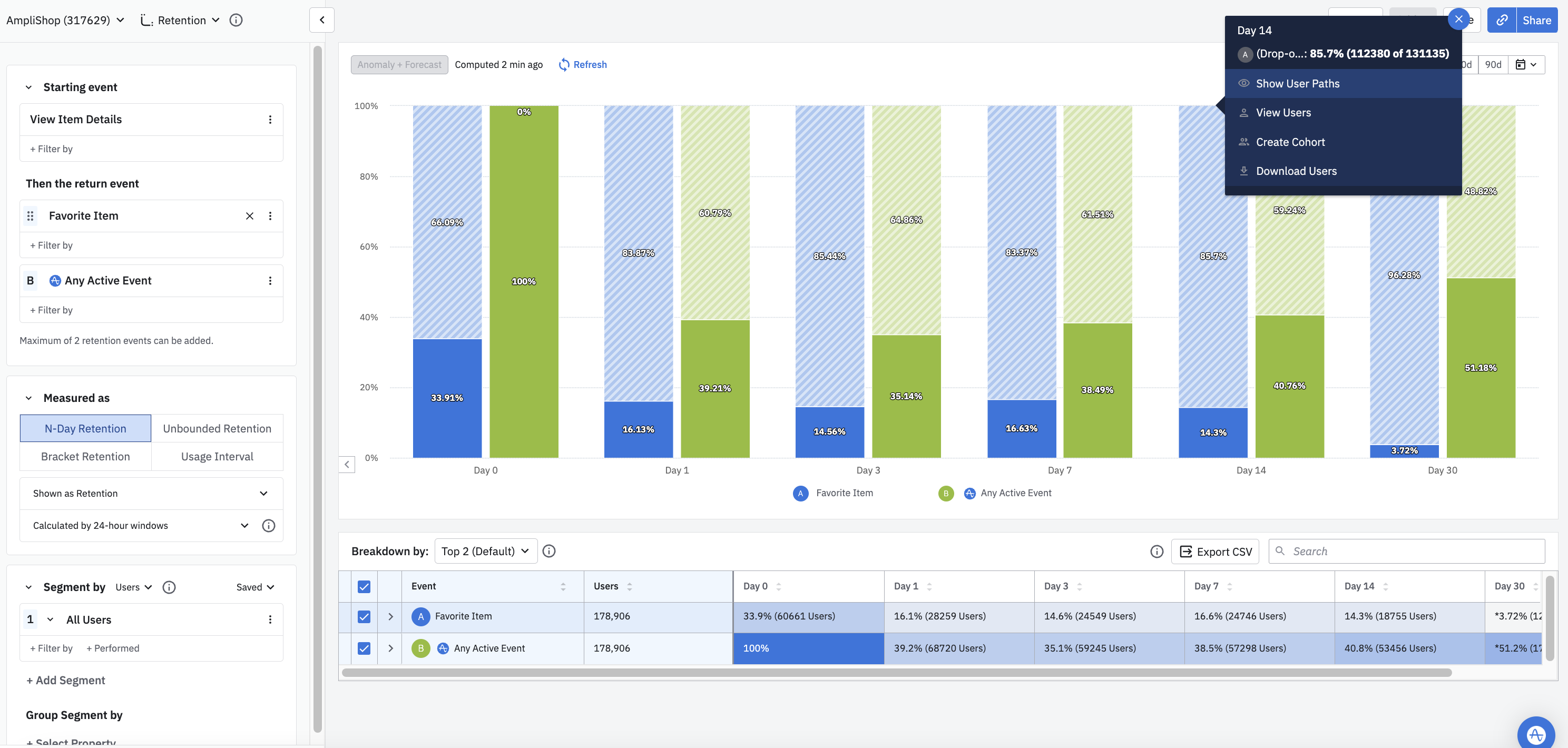

You can select up to two return events for your retention analysis. Each event will have its own analysis, and will appear as a separate segment in the chart.

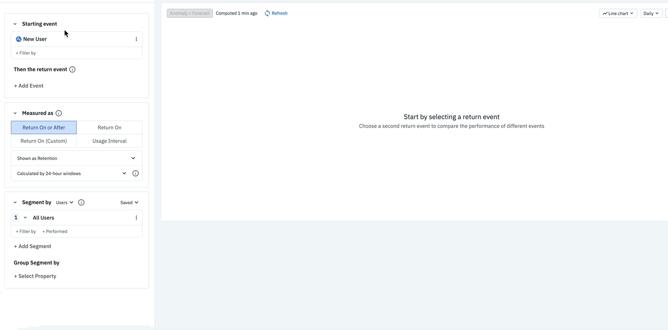

At its core, a retention analysis measures the amount of time between two different user events. You’ll just need to tell Amplitude what those events are, and which users it should include in the analysis.
To build a Retention Analysis chart, follow these steps:

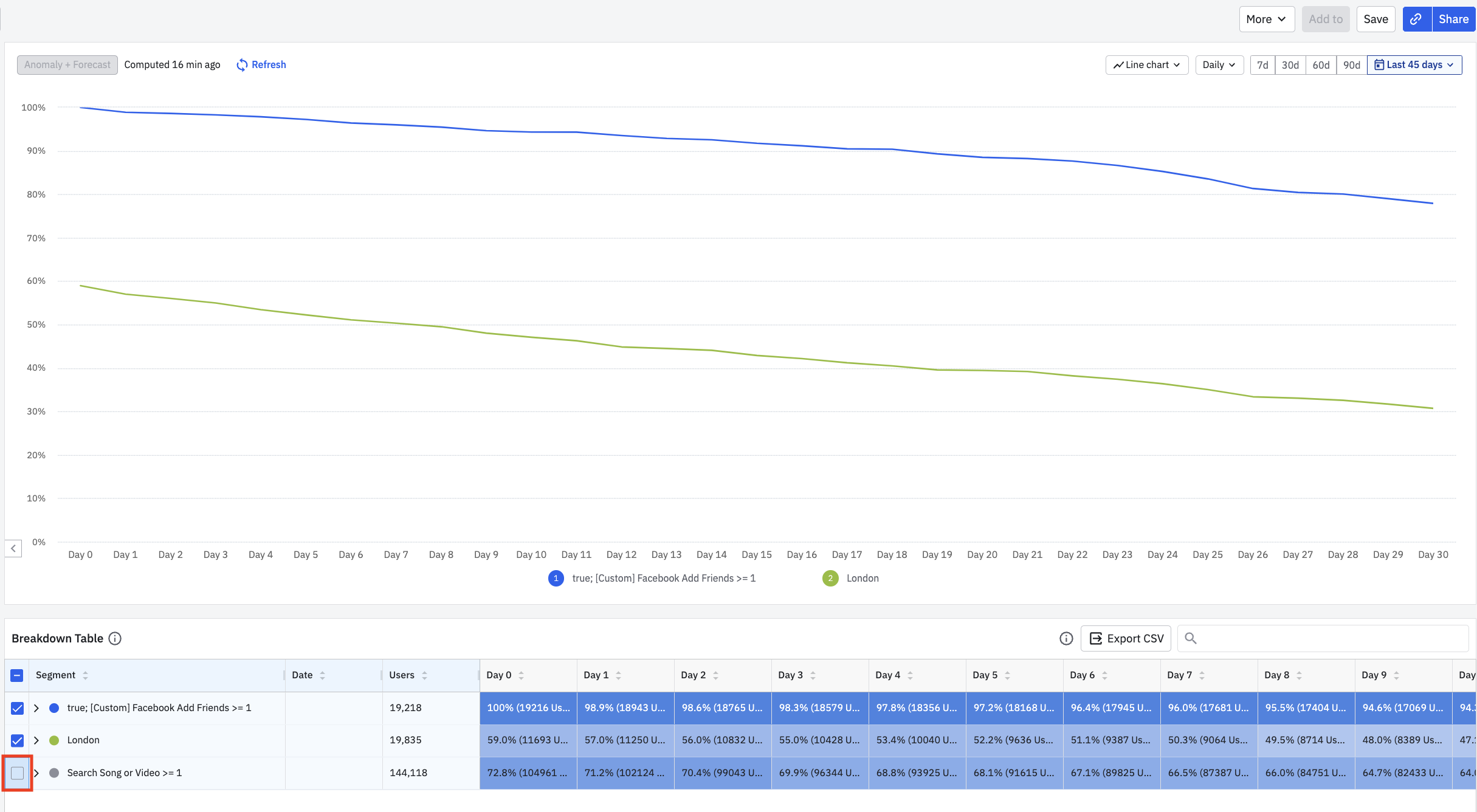

You should now see your Retention Analysis chart, along with a tabular view of your results in the breakdown table. Check or uncheck segments in the breakdown table to compare retention rates in the visual. For example, this Retention Analysis chart shows two lines for comparison because its third segment is unchecked:
The Retention Analysis chart also supports usage interval analyses.
