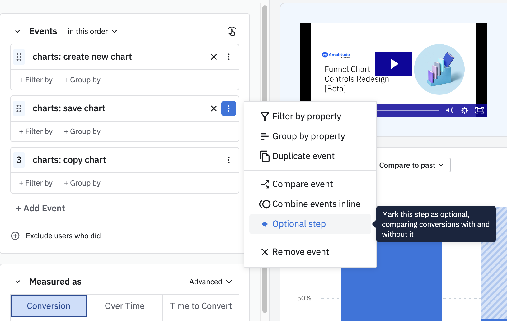

At times you will need to define a conversion where some of the steps are optional. For example, a funnel has steps A, B, C, and D, where B is optional. If a user performs steps A, C, and D, they would still convert.
Click More Options in the Events side control and select Optional step to make a step optional.

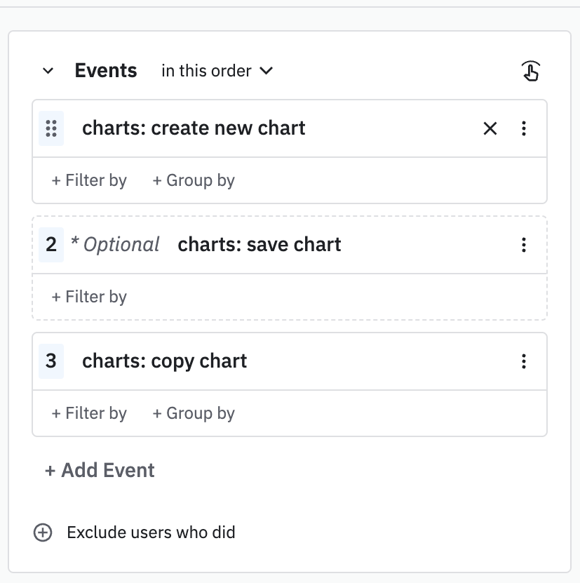

When an event is marked optional, the side control will say *Optional and have a dotted line around it.
The chart will then show two funnels - one with the step and one without the step. The conversion take-aways and breakdown table will also reflect these two scenarios.
