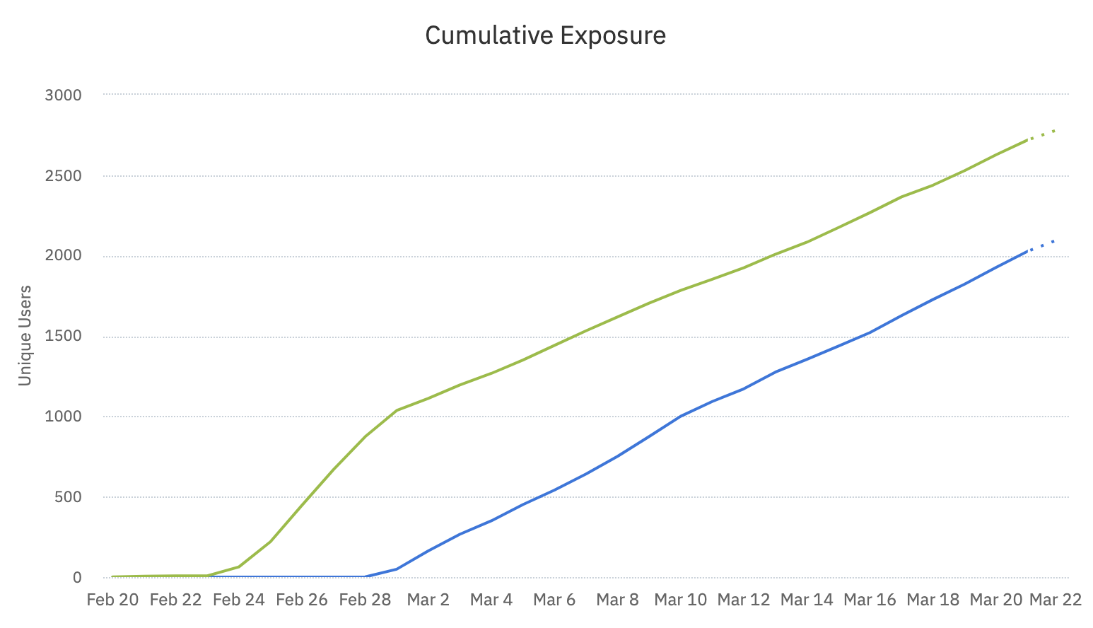

Sometimes your cumulative exposure graph will show divergent lines with similar slopes. This could be because your experiment started before all variants were ready.
In this example, the two variants began receiving traffic on two separate days, February 23 and February 28, resulting in a pair of staggered lines on the graph.
Ideally, you should not begin an experiment until all variants are ready to receive traffic. Adding a new variant after the experiment is underway can present a misleading picture of the results, since all variants were not subject to the same conditions for the same length of time.
Another potential issue is the novelty effect: where the newness (novelty) of a treatment can sway experiment results. In the example above, users exposed to the green variant may have had more time to adjust to the new experience. Finally, users exposed to that green variant have had more opportunities to trigger the primary metric, especially if it’s an unbounded time metric, thus making the comparison between variants unequal.

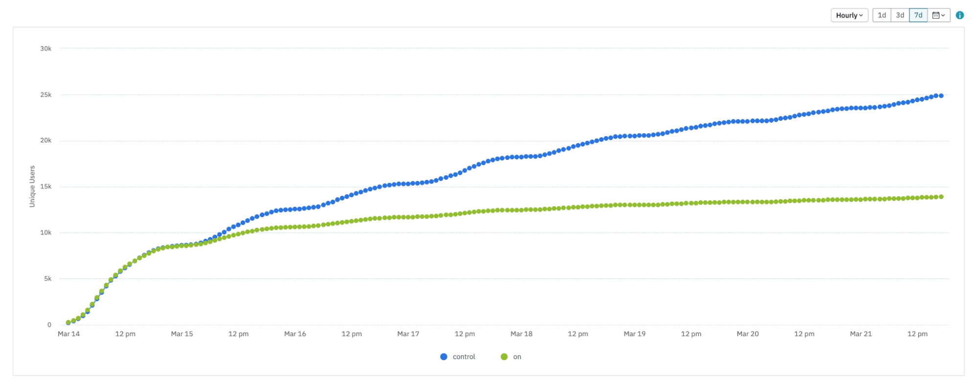

There are a number of reasons why you'll see divergent lines with different slopes in your cumulative exposures graph. If you’re using a custom exposure event, users may see old, cached variants of your experiment if they keep triggering the exposure event without triggering the assignment event.
For example, a user could be assigned to the control variant without triggering the exposure event. If in the future you set the traffic allocation for the control variant to 0%, that user could return afterwards and trigger the exposure event without triggering a new assignment event. That user will be counted as a control exposure.
This reasoning also holds for experiments with sticky bucketing on.
In this example, on March 15, this user rolled out their experiment to 100% for the control variant. Since sticky bucketing was turned on, we still see the number of “on” users increasing even after the traffic allocation is set to 0%. This happens because allocation occurs when the variant is requested via the SDK or API, so the variant can become “stuck” even without the user having been exposed to it.
You should keep in mind that when you select sticky bucketing and change the traffic allocation, you will not get the desired traffic allocation. Instead, you’ll get a weighted average between the two allocations, since the users who were previously bucketed will stay in their bucket. You’ll have to wait a bit to get close to the desired traffic allocation.
