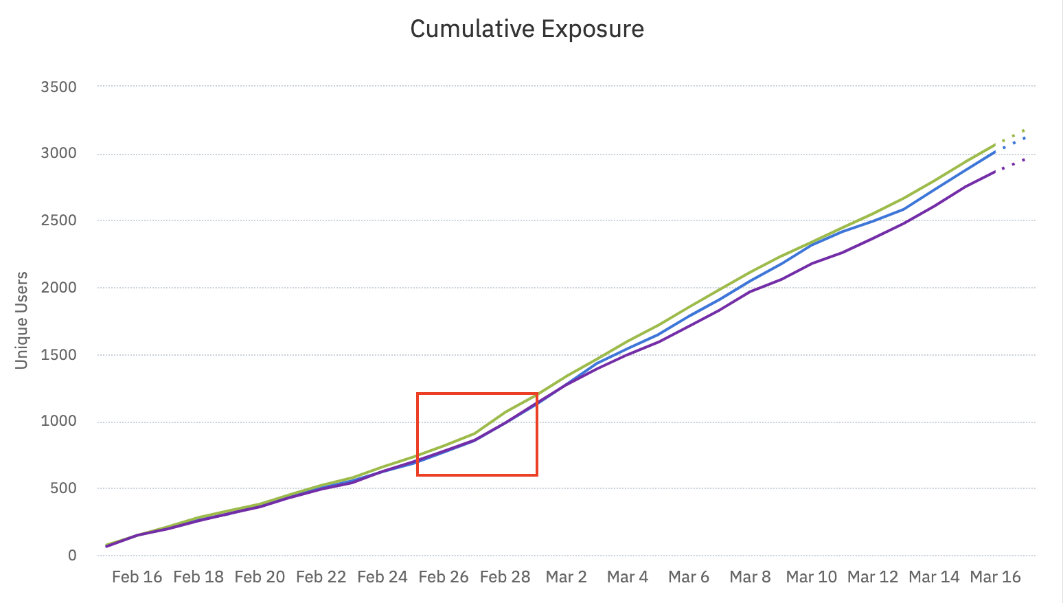

Sometimes, lines have an inflection point caused sudden increase or decrease in the count of exposures per day.
You can see here that on February 27, the slope of all three lines changed a bit, from around 70 users per day per variant, to about 100 users per day per variant. (Note that the slope can also flatten after an inflection point.)
There are several reasons why this could happen:
You shouldn't change settings for traffic or traffic allocations to variants in the middle of an experiment. Doing so can introduce Simpson’s paradox into your results. If you have changed the traffic allocation, try restarting the experiment by choosing a new start date. Avoid including any users who were already targeted.
Likewise, you shouldn’t change the targeting criteria during an experiment because the sample is then not representative of what would happen if you rolled out a variant to 100% of your users. Instead, consider gradually increasing traffic to the entire experiment, or doing a gradual feature rollout instead of an experiment.
For example, imagine that in the first week of your experiment, you target only Android users, and 100 of them see your experiment. The following week, you change the targeting criteria to include iOS users, and 20 of them see your experiment.
To this point, 220 users have seen your experiment after two weeks; 9% of them (20/220 = 1/11 = 9%) are iOS users. However, when you release your experiment to 100% traffic, you discover the true percentage of iOS users is actually 16.7%. In this case, you're underestimating the effect of iOS users. If the experiment shows a positive lift for Android users but a negative lift for iOS users, you may be rolling out a feature based on what you think is a positive experiment, but it's actually a negative.
Once you have answered the question of why the slope changed, consider whether you should adjust the end date of the experiment. With more traffic, you’ll reach statistical significance faster. If you're getting less traffic, statistical significance comes more slowly.

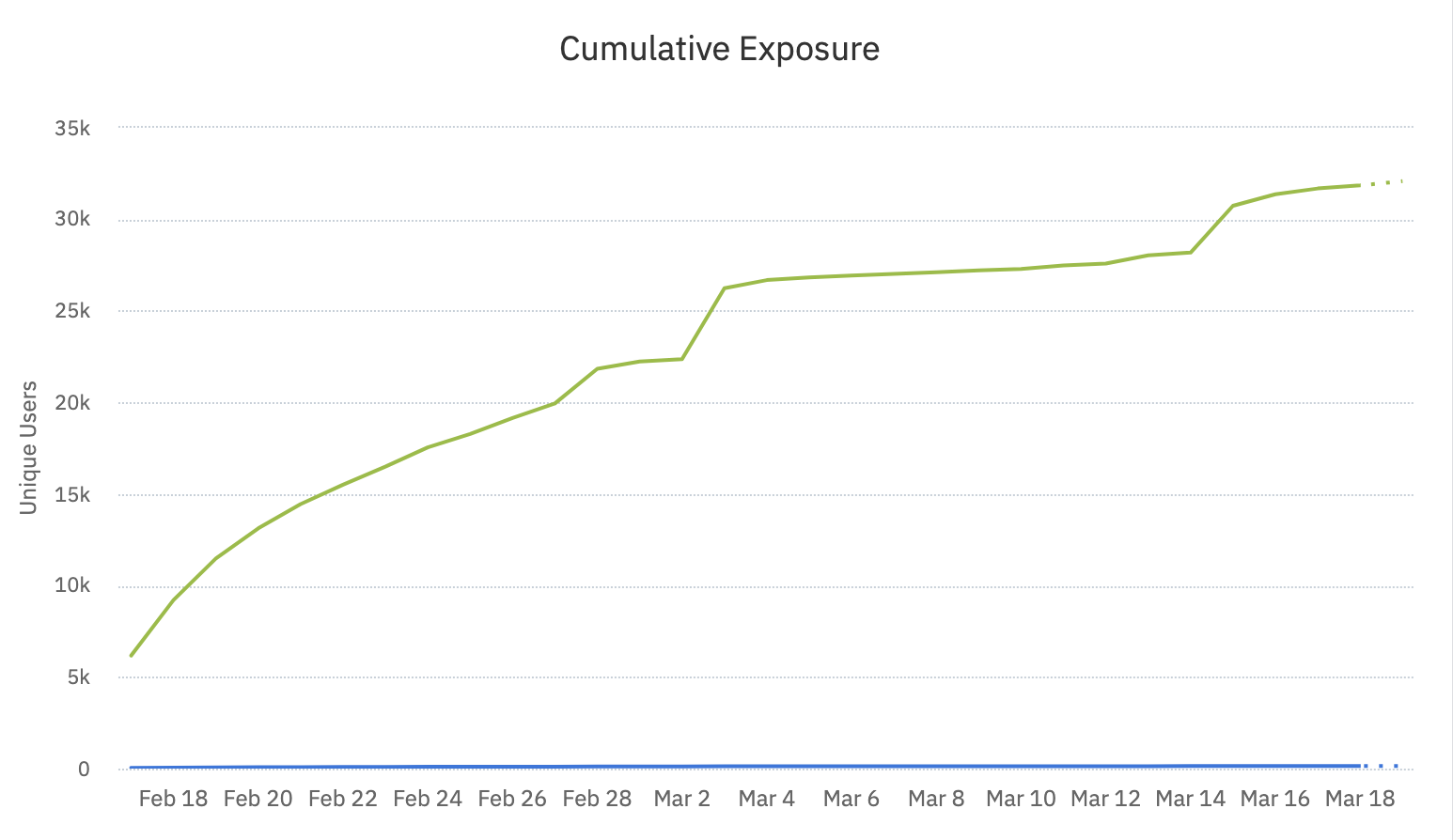

Focusing on the data from March 4 to March 11, the graph is fairly flat. This indicates that very few new users joined to the experiment during that time period. Potential explanations include:

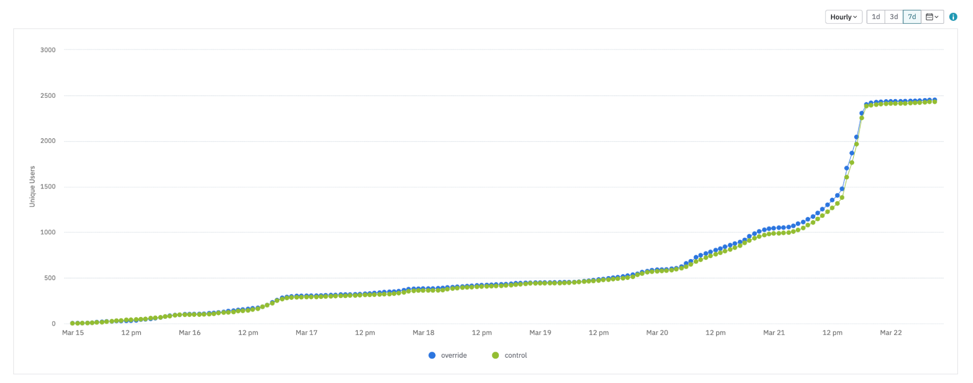

You can see a strong illustration of that last bullet point in this hourly chart:
Between March 21 at 7 PM and March 22 at 9 AM (the rightmost section of the graph), very few users were exposed to this experiment. But just before that, starting at around 5 AM, a large number of users were exposed. Yet on the left hand side of the graph, the pattern is one of users slowly trickling in. When you consider that an online gambling company is running this experiment, it makes sense that there would be these spikes in traffic when they run their jackpots.
