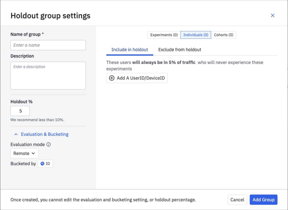

To create a holdout group
  1. In the Experiment functionality, go to Experiments > Mutex and Holdouts tab.
  2. To add a new holdout group to your project, click Add a new holdout group.
    • If you have existing groups, click Create A New Group, and then select Holdout Group.
  3. In the Holdout group settings modal, enter the name, description, and holdout percentage for the group. You can also view and change advanced settings such as the evaluation mode and bucketing key of your group.
Note
You can't change the holdout percentage after you create a group. This ensures consistent bucketing, as well as a consistent user experience.
  1. Click Add Experiment to add experiments to your holdout group.
  2. (Optional) Specify individuals or cohorts that you'd like to include or exclude from your holdout group. From either the Individuals or Cohorts tabs, add a user or cohort under Include in holdout or Exclude from holdout. This is helpful if you would like to ensure that specific users are either always held out, or never held out, from the holdout group.
Don't add the same users nor cohorts to both the Include a holdout and Exclude from holdout slots, as the Include a holdout slot determines inclusion.
  1. Click Add Group to finish the process.
