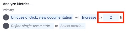

Before you run a experiment, set a Minimum Detectable Effect (MDE) to estimate how you'll measure success. Think of MDE as the minimum change you're hoping to find by running your experiment. Without a fail-safe calculation available for the MDE, it can be tricky to set one. With Amplitude Experiment, the default MDE is 2%. However, as the MDE is directly linked to your unique business needs, be thoughtful during each experiment's design phase. Considerations for setting the MDE should include the recommendation metric and any associated risks.

In Amplitude, the MDE is relative to the control mean of the recommendation metric. For example, if the conversion rate for the control group is 10%, an MDE of 2% (0.2) would mean that a change would be detected if the rate moved outside of the range 9.8% to 10.2%.
