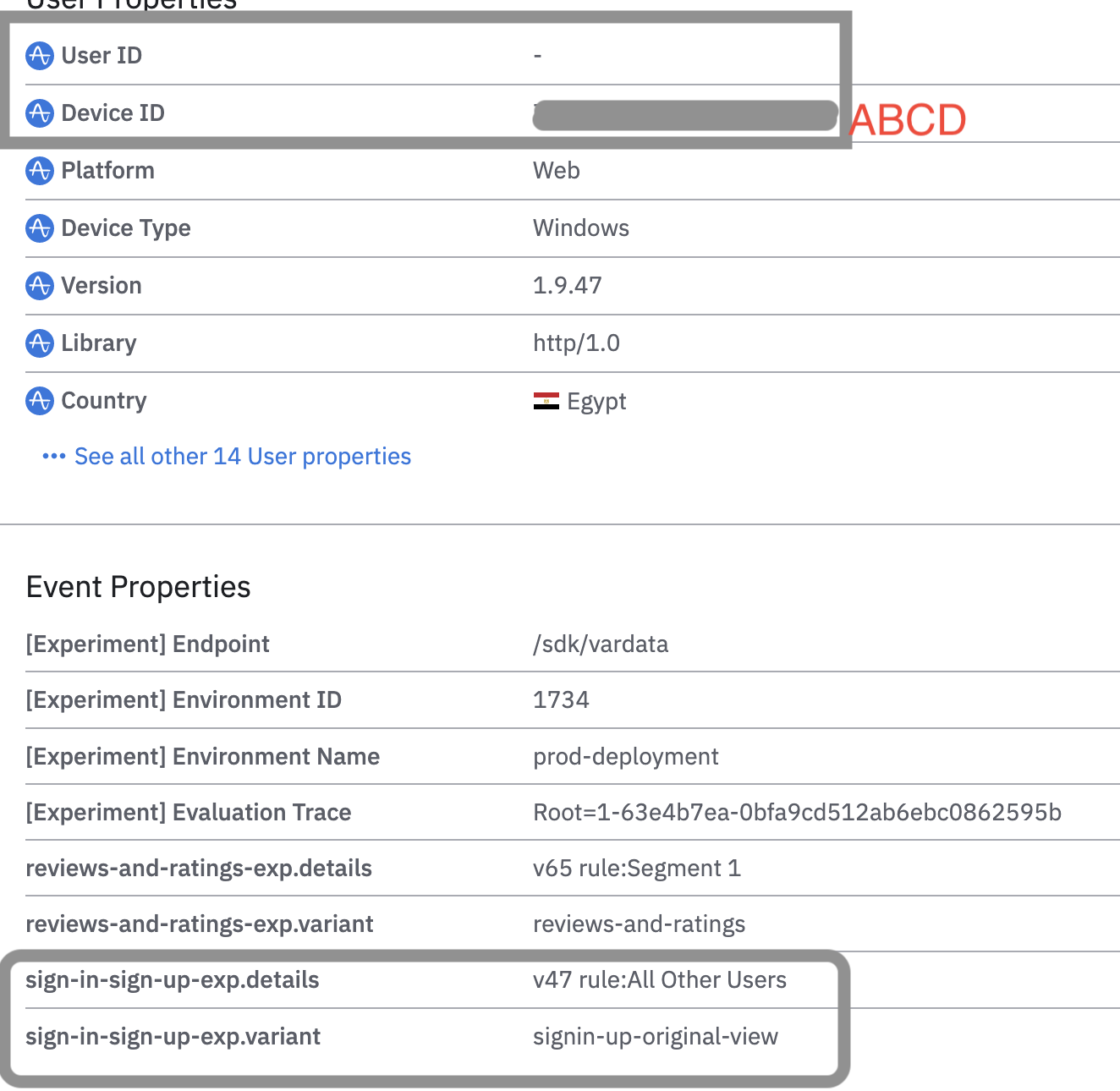

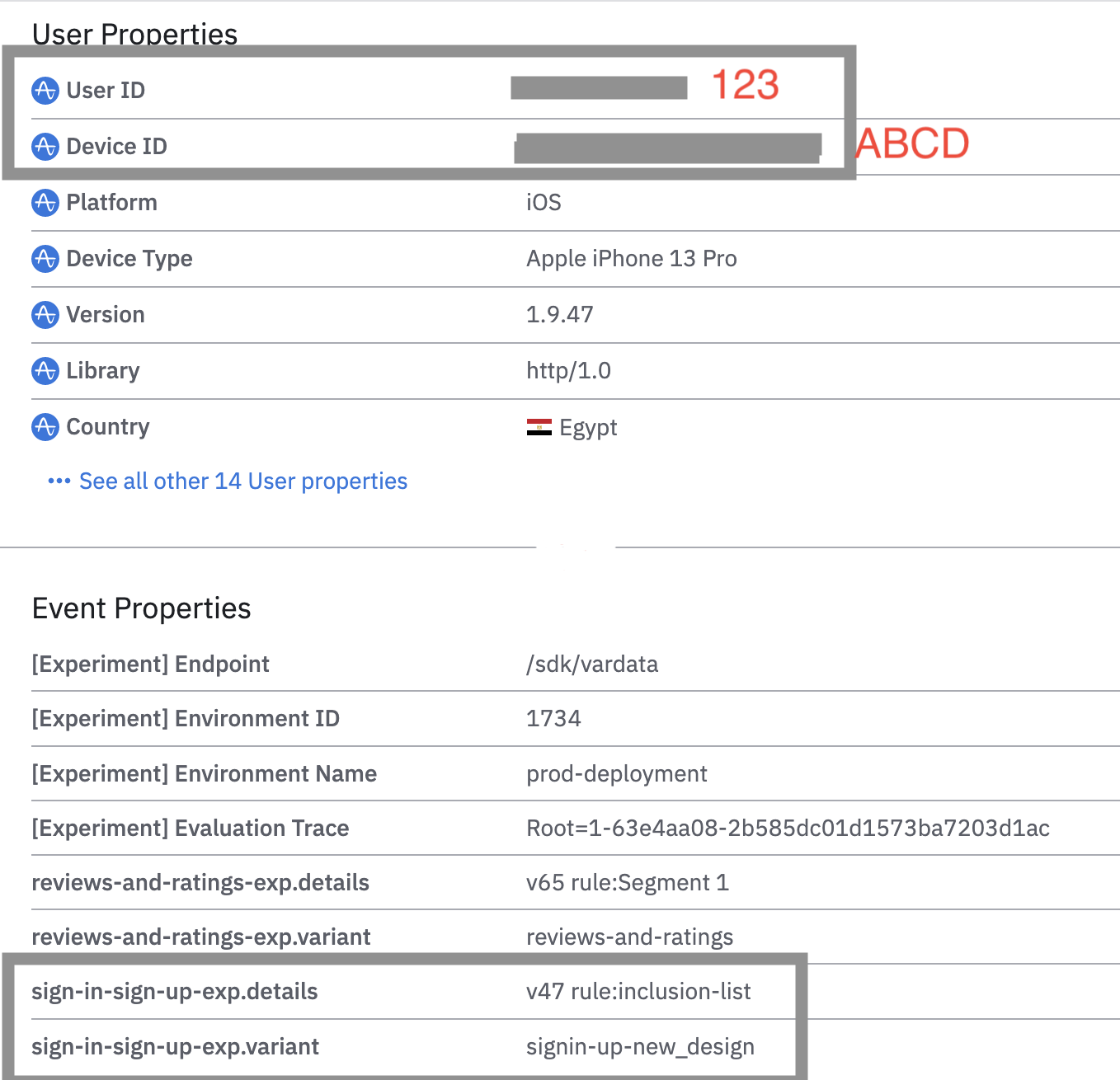

Inclusion list
Imagine you have some user IDs in the inclusion list. You call fetch() and pass the user ID in to the call. This returns the control experience, per the inclusion list. But the next time you call fetch(), you don't pass in the user ID. Now the user doesn't meet the inclusion list criteria, so Amplitude hashes the bucketing key, and the user may experience a different variant instead. The same thing can happen if you include device IDs.
In this example, the user has a user ID. They match the inclusion list and get the signin-up-new_design experience.
Has a user id so matches the inclusion list and gets signin-up-new_design
In this example, there is no user ID. The user doesn't match the inclusion list, is included in the "all other users" segment, and gets the signin-up-original-view experience instead.
Doesn't have a user id so doesn't match the inclusion list and hits the all other users segment and gets signin-up-original-view
