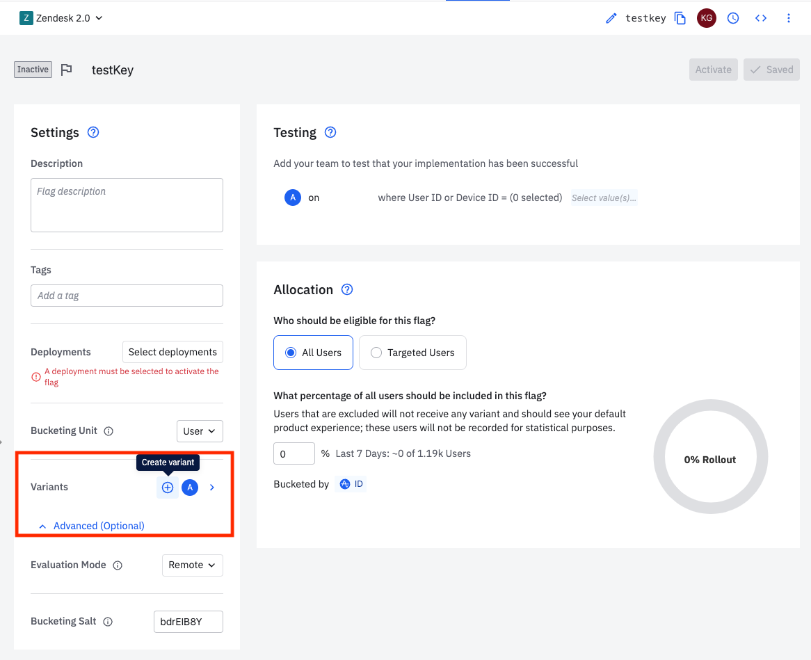

Create a new flag
You can't create a new flag until you’ve created a deployment, and either installed the SDK or are set up to call the evaluation REST API. After you've done that, follow these steps:
  1. Navigate to Experiment > Feature Flags in the left-hand sidebar and click Create A Feature Flag.
  2. In the Create Flag modal, choose the project that includes this flag from the Projects drop-down menu. Then, give your flag a name. Experiment generates the flag key from the name you choose. The flag key is an identifier for the flag used in your codebase.
  3. Specify the evaluation mode for your experiment, either Remote (for example, Amplitude evaluates it on Amplitudes servers) or Local. Then specify the bucketing unit you want to use for this experiment.
    Tip
    The best bucketing unit is usually the user. However, in some B2B use cases, you might want to use company ID or city as the bucketing unit. For example, bucketing by company ID ensures that all users in a particular company have the same user experience. Be sure the Stable Unit Treatment Value Assumption holds for whichever unit you choose.
  4. Click Create. Experiment opens a blank template for your flag.
  5. Choose the deployment for your experiment from the Deployment drop-down menu. For more information about working with deployments, go to this article on configuring Amplitude Experiment.
  6. Click Advanced Settings to change the bucketing salt.
    Not
    Changing the bucketing salt may let users might switch between variants in your experiment. For that reason, Amplitude recommends not to change the bucketing salt without guidance. For more information, go to How randomization works in Amplitude Experiment.
  7. In the Settings section, click the Add icon in the Variants section to add a variant. Flags must have at least one variant. The variant is the new feature or product experience you want to roll out to users.
You can add as many variants as you need to a feature flag.
  1. Type in a name, value, and a description for your variant in the appropriate fields. Amplitude Experiment generates the variant value from the name you enter. The variant value is a string that you’ll use as a flag in your codebase. When you’re done, click Apply.
Note
Don't name your variants OFF. This is a reserved name for fallbacks in Amplitude Experiment (for example, the user segment not included in your experiments).
