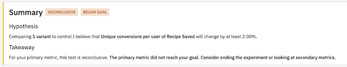

Summary is available to organizations with access to Experiment who have recommendations enabled.
The Summary card describes your experiment's hypothesis and lets you know if it's reached statistical significance.
Amplitude considers an experiment to be statistically significant when Amplitude can confidently say that the results are unlikely to have occurred due to random chance. More technically, it’s when Amplitude rejects the null hypothesis. That may sound subjective, but it’s grounded solidly in statistics. Statistical significance relies on a variant’s p-value, which is a value that represents the likelihood that your results occurred by chance. A lower p-value means your results are probably not random, and there's evidence to support your hypothesis. If this value drops below a threshold, Amplitude considers the experiment to be statistically significant.
The Summary card displays a badge labeled Significant if the experiment reached statistical significance, and a badge labeled Not Significant if it didn't. This card can display several badges at once:

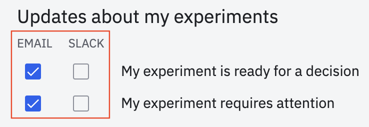

Your preferred notification settings allow you to receive experiment updates by email or Slack.
Click the check box next to the notification:
Amplitude Experiment sends a notification to the editors of the experiment.
