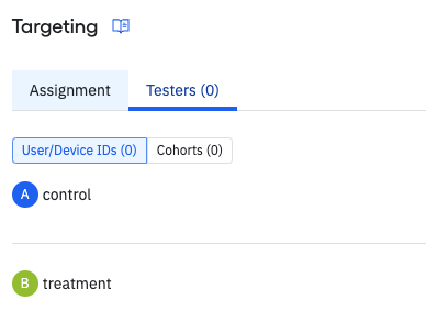

Define your testers
In Feature Experiment, use the Targeting settings to define your test users.
Add users by User ID or Device ID, or using a cohort. Test users are assigned a variant, and that variant is what they experience when interacting with the experiment.

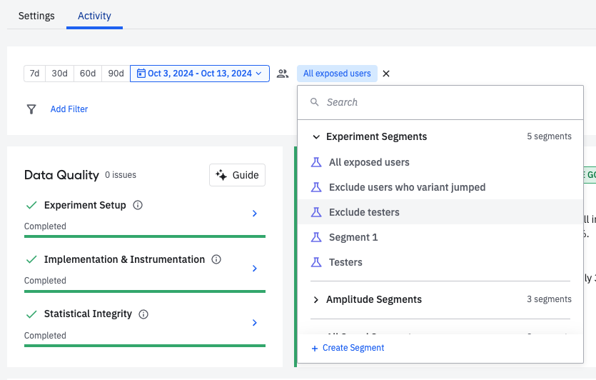

Filter test users
If you want to remove QA users or internal traffic from analysis because those users aren't representative of your customer base and may skew results.
Click the All exposed users dropdown and select Exclude testers.
If you selected multiple targeting segments, analyze each segment individually because you may experience a lift in one segment. Click the segment name in the All Users dropdown. This also filters testing users from your analysis.
